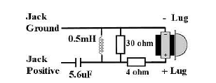

Here's what my plans show

Ok thanks jimbo7, that's not in my original Omni 12 TB these are in the plans:
Yours have a totally different 1" which is Apt 80 on the original plans, unless Bill revised these plans recently?
Thanks now Im really confused! :confused:

jimbo7 wrote: Sun May 10, 2020 3:30 pm Here's what my plans show
That's not from the Omni 12 TallBoy plans.

Bill Fitzmaurice wrote: Sun May 10, 2020 4:40 pmThat's not from the Omni 12 TallBoy plans.
I feel so stupid. No wonder I didn't understand his crossover components. :wall:
