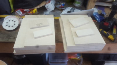

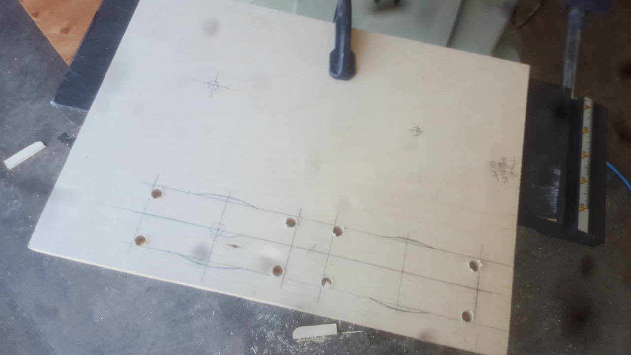

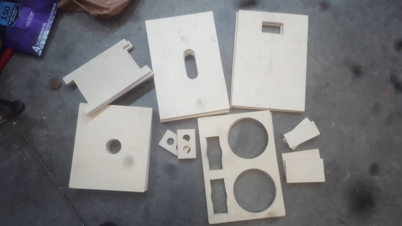

Today I cut all the panels and sketched out all the holes and contours.

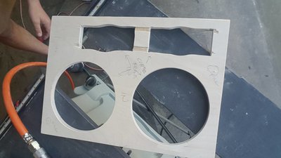

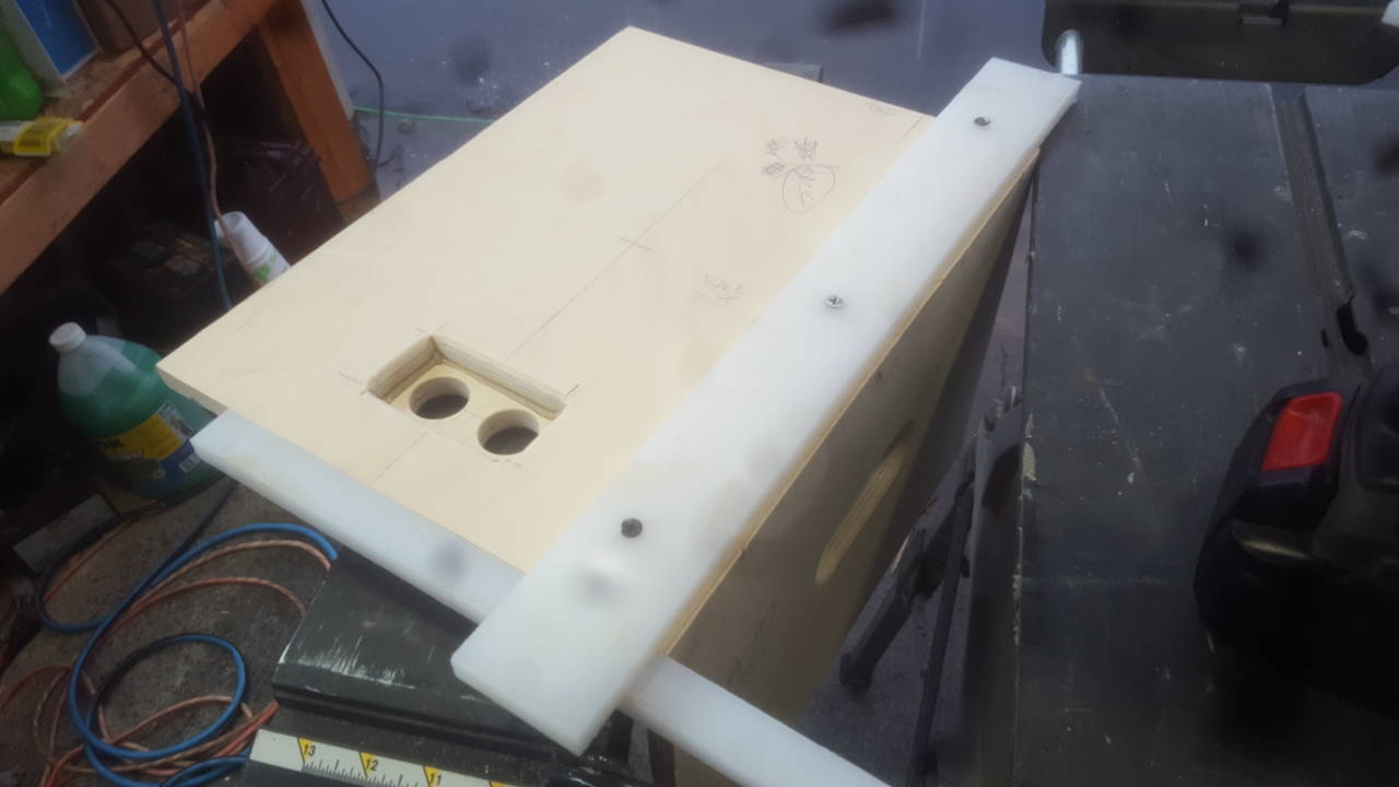

Decided to carve all the holes out today and start assembly tomorrow. Drilled starter holes for the jigsaw...
Ended up getting some tear-out from drilling. Fortunately, on the inside side. Speaker holes cut.
Chamfered the back side with a round-over bit to give a little extra clearance for the connectors.
All carved up, chamfered, sanded, and ready to go together tomorrow.

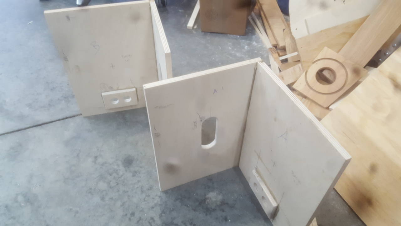

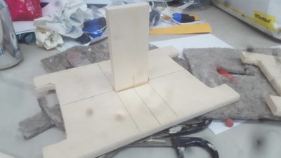

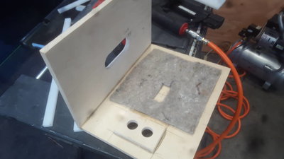

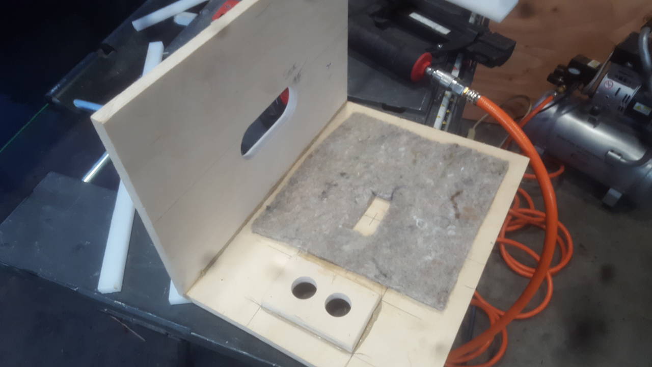

Got going on assembly today. Made a mistake and fortunately caught it before the PL set. I put the back-to-main brace brace on the wrong axis/plane. Horozontal instead vertical.
Didn't catch it until I mocked it up to the felt covered back. Other than that, I think it all went okay so far. Put the jack plate in, mounted a side to the back for both speakers, and attached felt with spray glue. It was later in the day when I caught my mistake. Was kind of burnt out, so I just disassembled and cleaned the pieces for tomorrow.
