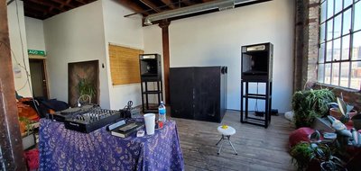

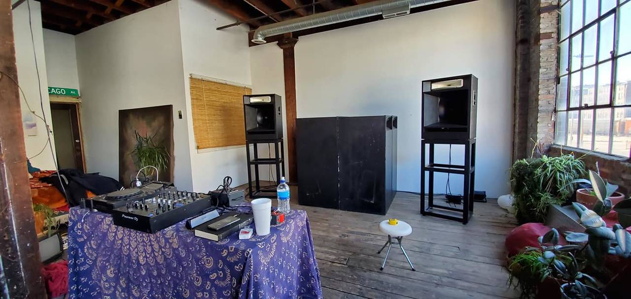

It's been a long time since I've been here. This is our current setup. Temporary.
We had the 4 T60s and 4 Jack10s installed in a small 60 persons club for almost 5 years. The owner sold the space in March of 2019.
This setup is in my friends loft. Very cool spot. Very strange setup as it is in an old industrial building. Realistically the space is probably 80'x160', but it is all cut up into smaller sections with lots of partial height walls and few full height walls.
I've never been very good at tuning my system (which is testament to how good the Tuba 60s are because the dance music community here really thinks I know what I'm doing, I try to be humble and admit I do not). As we know the Jack 10s didn't really compare to the T60s, thats a long story and I take responsibility for making poor decisions and being in over my head during the build all those years ago.
I recently found these old Acoustic PA tops for peanuts.. threw some B&C 15"s and Selenium horn drivers in them and I'm very happy with how they sound for this temporary fling (a series of 4 bi-weekly events, 3 left to go!)
Anyway, we have limited hours (Sundays only) to really let it rip, eq, tune, adjust so I'm posting here to potentially expedite things.
The first event looked slightly different to the photo, and I'm fairly sure these adjustments made dramatic improvements but I can't measure until Sunday.
We first noticed that having the subs on the ground just didn't have the power we were used to in the smaller space so I remembered an old post here about a guy standing them up. I stood in the sweet-spot while my buddy started to lift the first one up. I had a 60Hz sine wave playing and it was so dramatic that we all took turns experiencing it. lifting the sub up to face the ceiling was like grabbing the fader on the console and pushing it up 9dB. So we put all four subs in a line against the wall. Well, after thinking about it and experiencing the first gig I was realizing that the 2 outside subs were pretty far away from each other. We now have them in this cube shape, yet still facing the ceiling. I'll know more later, but subjectively things seem much cleaner and I was able to drop the sub output on the DSP 4dB to keep a matched "perceived" balance.
I also moved the tops out of the corners a couple feet. Just based on a simple google search of distance from wall.. any further tips/science here would be appreciated! I'm not set on my acoustical crossover yet.. but electrically it is currently at 98Hz.
Looking at the photo, any tips or criticism is helpful.

Re: Trying to dust the cobwebs off.
G'day, welcome back!
Righto, first things first.
You need some space. Say 20 metres OUTSIDE in every direction from the mains cab before you hit any type of obstruction.
Record your response so you can analyse it later. Presumably the mains cabs have passive internal crossovers so that's taken care of.
Having a chart can also assist with determining a baseline EQ.
Sounds like you want to bi-amp, so you need to include/link SPL charts from the manufacturers of the drivers you have installed and their specs to be able to assist there.
Once you know what your mains response is like, you can set a crossover point based on information and not guesses, because you already have that information for your subs.
That gets you an electrical crossover point.
However, if you do again what you've already done, ie alter subs response by the 4dB you did to achieve balance, you've already altered the acoustic crossover point!
In order to work out how much you've altered acoustic crossover point, you have to plot subs and mains on one chart, including the selected subs low pass slope and value (eg LR24), and the mains high pass slope and value (eg LR24), then move each line according to what you've done is DSP to determine the final value...

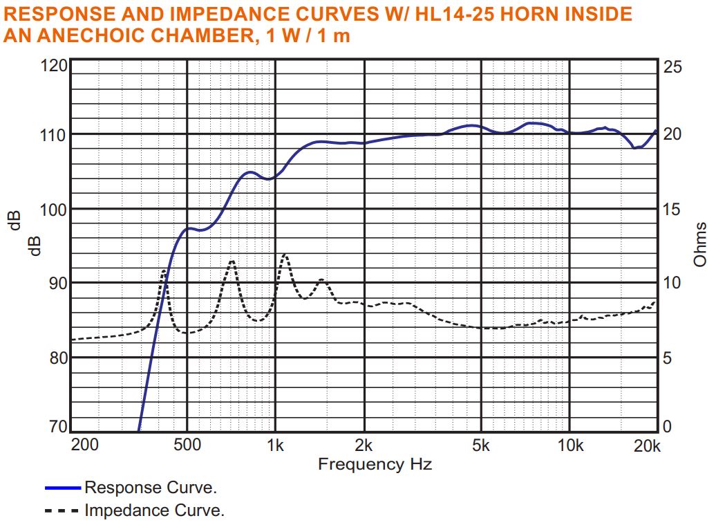

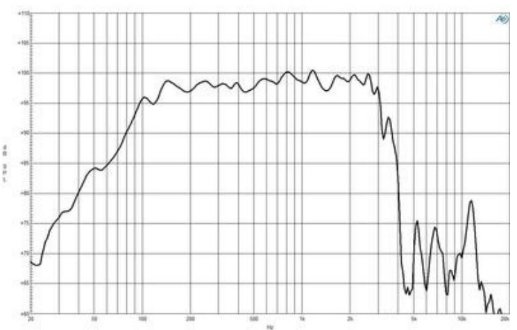

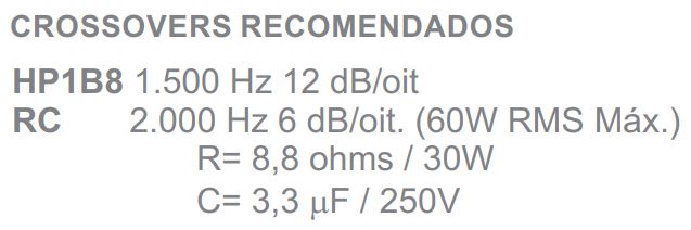

Thank you very much for the response Grant!
The x-overs in the mains were damaged which lead us to just bi-amping.
JBL response: JBL recommended x-over: B&C response: I do not have the opportunity to take the mains outside for testing before the next gig. well.. at least not with the 20-meter space. Definitely don't have a crane!

You don't need a lot of space to measure mains. Since the longest wavelength they pass is only 12 feet or so being at least that far from buildings is adequate, especially if your gear can do a gated measurement. Do a ground plane measurement to get the result up to 250-300 Hz, put the cab on its back and take a measurement with the mic suspended above the cab to get the result above 250-300Hz, splice the results.
When you get the chance, go and do what Bill has suggested above.
It's not best practice. Best practice is to think and do well before the gig.
In the meantime, to get the "gig" done;
For the mains, try a 2K high pass on the JB's with a BW12 or 24 slope, and a low pass of say 18K, LR24.
That's 2 outputs on your DSP, HF left and right.
I don't like running subs above 100Hz, you may feel differently, but those B&C's dive from 100Hz down,
so high pass them at 100Hz, LR or BW 24 or 48, low pass at 2K with a BW12 or 24.. That's 2 outputs on your DSP, mid L and R.
If I have said 12 or 24, or 24 or 48, LR or BW above, try them, see if one sounds better than another to you.
Subs, high pass at 25Hz LR48, low pass 100Hz, LR or BW 24. One channel on your DSP (run them in mono). Set your limiters.
They are dance parties. I suppose. Our community is pretty diverse in the electronic realm at least. House, techno, dnb, ambient, experimental, dubstep, hardcore, electro and including all the sub genres of each... lofi, classic, minimal, EDM-esque... trap, hiphop. But all djmixer out... attendance ranges from 12-200 people depending on time of day.himhimself wrote: ↑Sat Feb 22, 2020 7:22 pm Oh, to have an island of t60s!! I went back a looked at your post again, but don't see what kind of gigs these 4 "events" are. What are you actually doing with the system? Good luck, and keep the posts on your progress coming.
