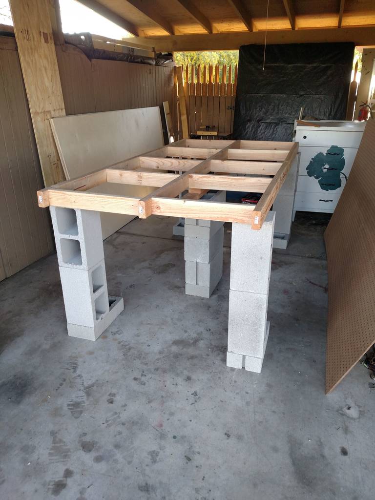

Got the cutting table off the ground and ready to start measuring cuts

Is that "table" gonna be stable enough to rip a full sheet?

Its alot more stable than it looks, i ripped all 3 sheets on it today without any problems. If one were to use all horizontal blocks it would definitely add stability, and i looking back i should have the blocks placed a bit more under the table rather than the corners. Regardless i wouldnt recommend using cinder blocks for safety reasons, but they are cheap i already had a bunch and seemed to work pretty well.

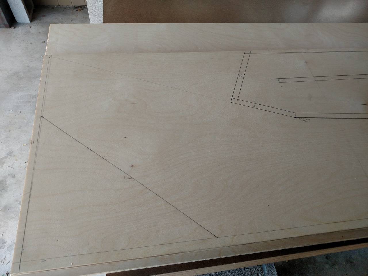

Im still in the process of cutting panels down, but i have a question, im building the thtlp front firing model. In the plans it shows panel 11 and panel 1 cut leaving an open triangle behind panel 12, would it be detrimental to leave panel 1 at 71.5" and cut panel 11 to 17.5"? Picture attached for reference.
Posts: 28981
Re: First build 24" thtlp!
It wouldn't bother anything.

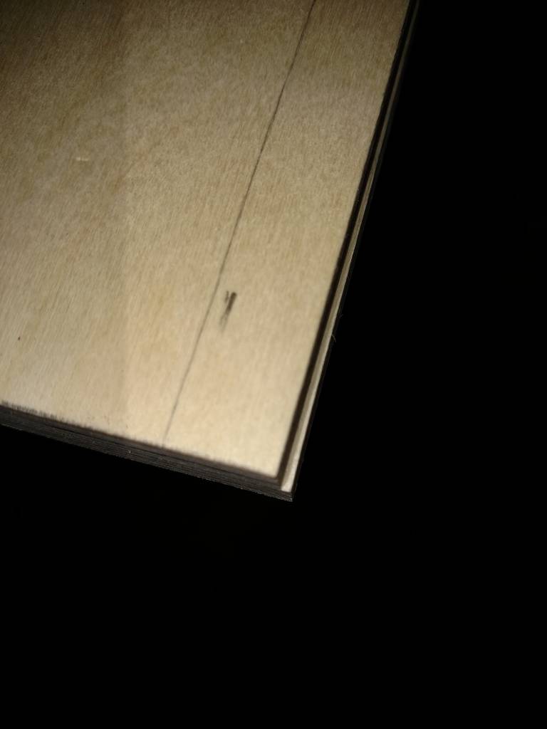

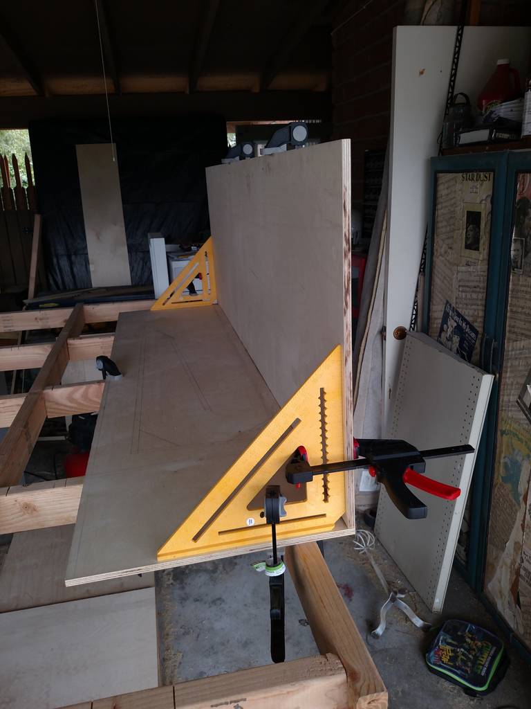

Well, progress has been made, most of my cuts came out on the money, i had one rip measure 1/8th of an inch shy, so it got purposed for the interior panels. I also had an error at the end of the 18" panel, which is also about an 1/8th of an inch over a 8" run, so im going to give that panel another shot and use it for bracing. I should have some more pictures on wednesday.

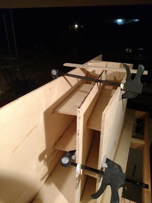

Haven't had a whole lot to report, i re-cut the panel pictured above, and got panel 1 installed today. I used an interior jig with a few brads to hold it in place for easy removal. I also cut little sections off a plastic speed square to leave room for squeeze out.
Posts: 8597
#14 Post by Bruce Weldy »
-Russian-spy- wrote: Sun Feb 23, 2020 4:09 pm I used an interior jig with a few brads to hold it in place for easy removal. I also cut little sections off a plastic speed square to leave room for squeeze out.
Good thinking but go ahead and build some jigs out of 3/4 ply.....much easier to clamp than a speed square.

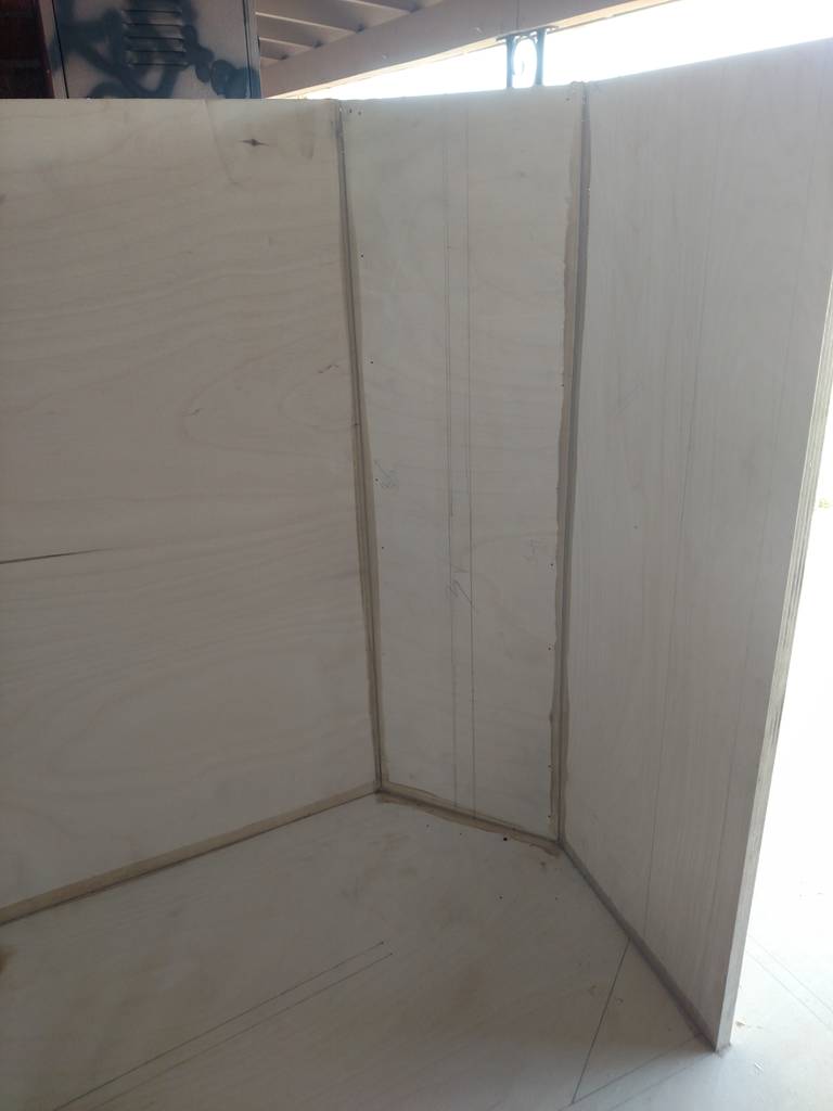

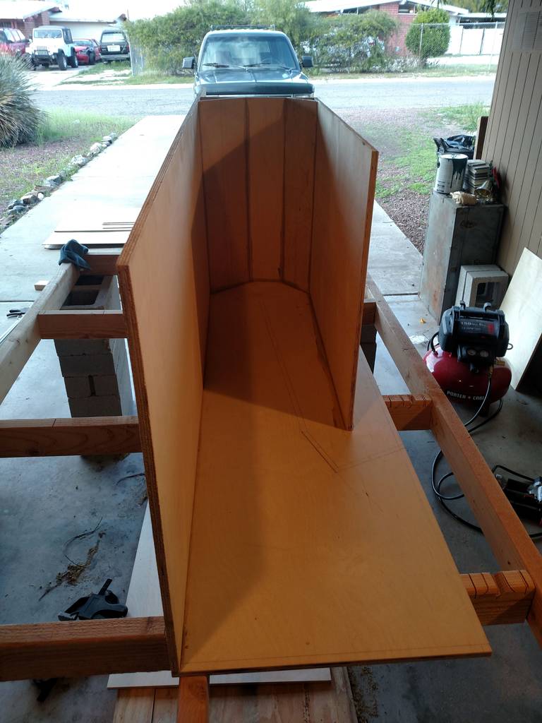

Well, im happy to report that progress has bren made, and things seem to going fairly smoothly. I made a bit of a mess installing the braces, and i have a bit of a concern about panel 4and 7, it seems as though i did not install one of them perfectly square, there is a little less than 1/4" difference between the two panels when measurements are taken from the bottom compared to the top. I put a few brads in the braces before i caught the discrepancy. How big of an issue is this?
