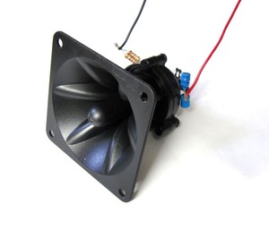

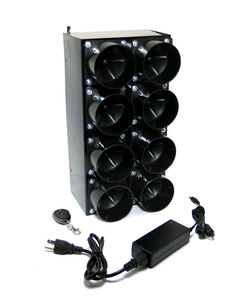

I am currently working on building an LRAD/Alarm/Ultrasonic Speaker array to deal with daily homeless tweeker loser drug addicts tresspassing, vandalizing, stealing on my business property.
Link to what Im working on https://www.amazing1.com/products/phaso ... tubes.html
Video of the system working is shown at bottom of the page link.
The transducers/tweeters are here; https://www.amazing1.com/products/trans ... ators.html
They look to be a typical cheap piezo tweeter in the 10-40khz range.
I have had the pleasure of renting one of these to verify operation and it is great for the size and functional. Per advertised its fantastically irritating. These can also be built from plans which I am doing.

Phasor Pain Field Generator & RC, High Power (8 Transducers + Focus Tubes)

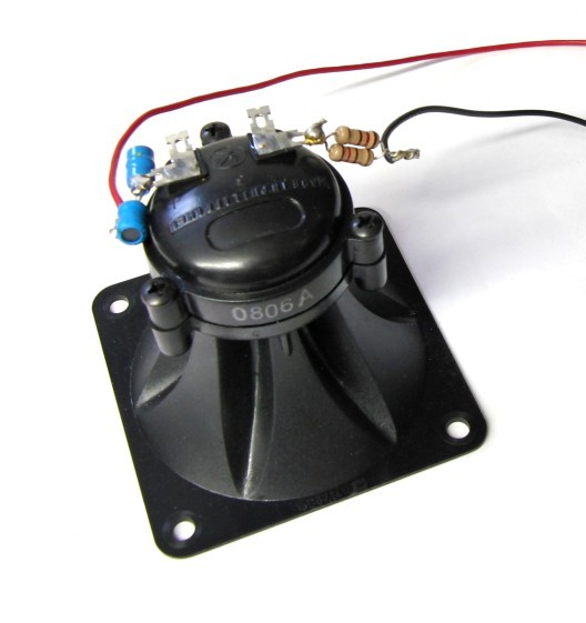

#2 Post by Bill Fitzmaurice »
Look familiar?
https://www.speakerhardware.com/goldwood-piezo1005.php
There's nothing out of the ordinary at the site you linked, other than their exorbitant pricing.

#4 Post by Bill Fitzmaurice »
All piezos have roughly the same capacity. Being capacitive loads they're voltage limited, not power, at about 25v. To get higher output our piezo arrays are wired series/parallel, for a 50v limit. That, along with the proprietary high pass filter we use, allows them to keep up with a 450w woofer in a DR280. We use 1016 piezos in arrays because the 1016 horn shape is better suited to the task. The drive element of 1016 and 1005 is the same.
