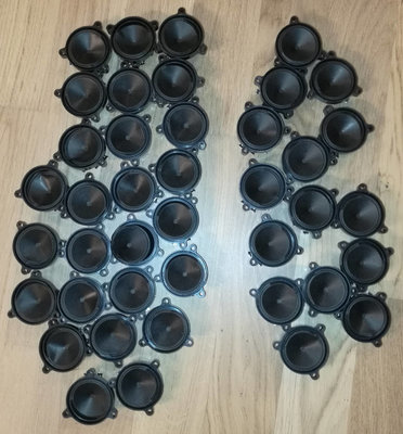

Because of the different sensitivity I measured the capacity of every piezo.
Of the 88 pieces I get a range between 147 nF and 177 nF. The average capacity was 159 nF.
Because I don't want destroy the tweeters while cutting and painting the pastic horns, I opened all the piezo-tweeters.
Did you ever opend your piezos?

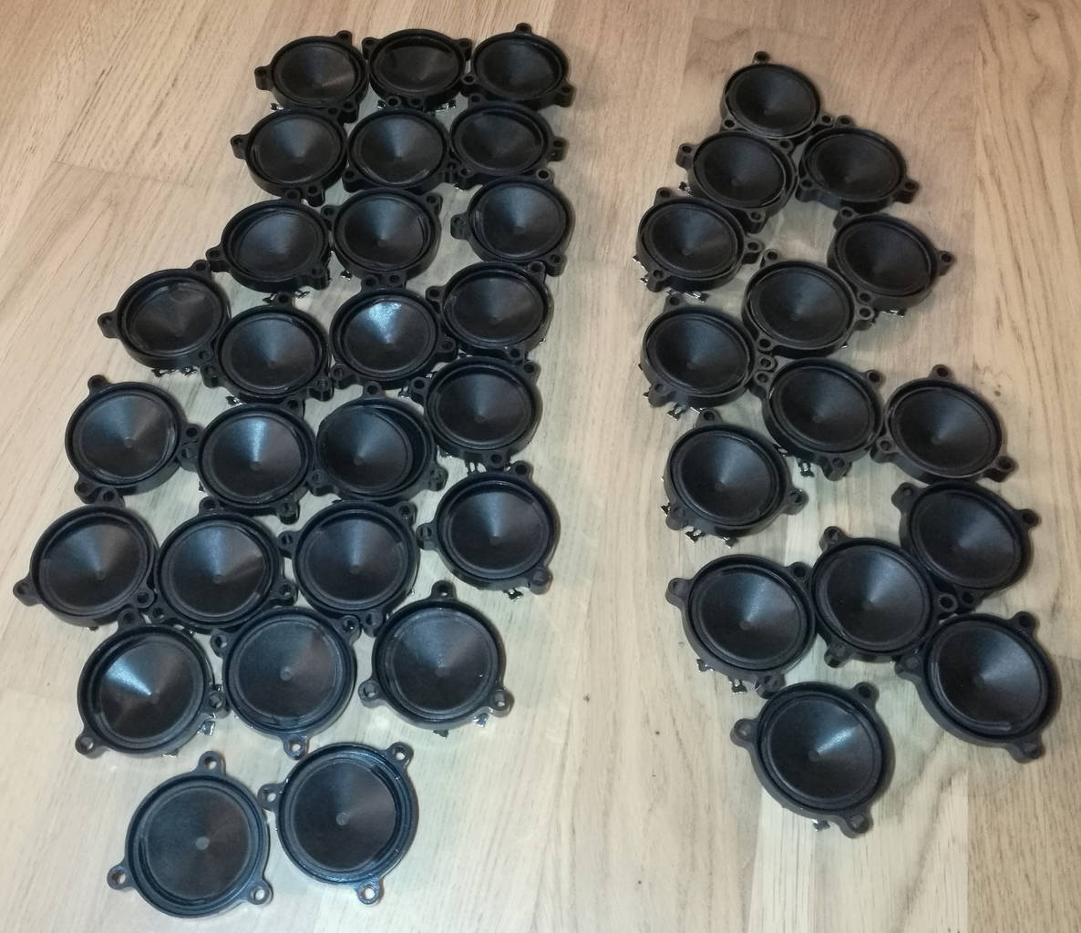

Out of 88 pieces, 41 have a deformed paper membrane. Some a little some extremely heavy (like you can see in the pictures).
Do you know if I would hear the deformed paper membran later in the melded array?
Do you know a solution to fix these deformations?
I think the little deformation I can maybe carefully fix with my hands.
For the really bad ones I think the cables are to short and the piezo elements aren't centered. For these piezos I could try to desolder the metal connection and solder longer cables to the piezo elements.
I'm a electrical engineer so the soldering job wouldn't be a problem for me if the procedure could be the solution.
Thank you very much for your help and answers.

I've been through plenty of piezos and opened enough too when spray painting arrays. I can honestly say I've never seen any like that. Given the small vibrations of the piezo and distance to the plug which sits into the cone, those deformations must have an effect on output.

Small sensitivity differences in piezos balances out in an array. When I'm checking phase with the reverse polarity rig and SPL meter i write down the loudness of each one. The deformation you uncovered may or may not be viewed as a manufacturing defect by the manufacturer. The diaphragm / surround is possibly not highly structurally loaded under working conditions, so durability may not be affected if not clamped properly between the housings. Given the lowish value and aggregation when working, if they're working when one tests them, stick 'em in an array would be my philosophy. One needs to satisfy ones self however. The manufacturer may have changed something or they may be chucking them out with less quality control due to all the BF purchasers, who knows.

Yes, I think that something in the manufacturing process went wrong, too.
I wrote to goldwood and they will talking to an engineer.
Goldwood told me that for my problem I have to find a solution with parts-express because I didn't order from goldwood.
I think that the small deformation wouldn't be a problem in an array because with a gentle tweezer fixing they schould be as normal.
But I'm concerned about the bigger deformated piezo tweeters which have not centered piezo elements because of too short cables.
But thank you all for your answers.
