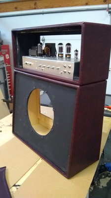

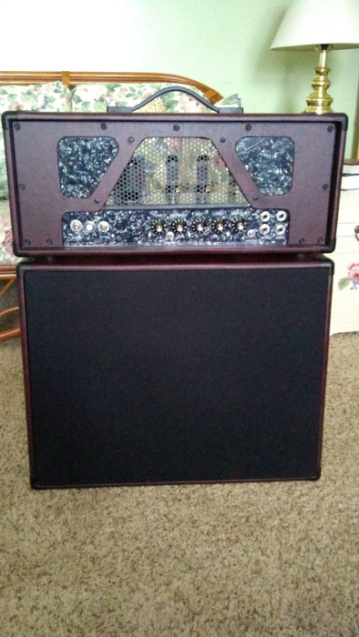

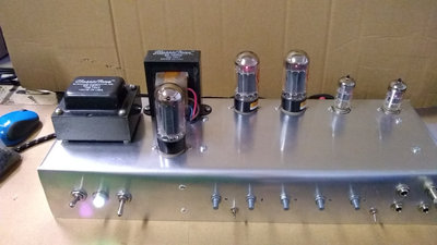

Last spring, I needed a project for an computer/networking/electronics program. I went old-school...designing and building a hand-wired tube guitar amp. I was able to make the amp work in time to graduate in May, but it took a bit longer to finish, as these things often do. Over the past month, I was able to add the looks that I didn't have time for earlier this year.
It's based on a 5E3 Fender Deluxe, but has a bunch of mods and tweaks...I can't play guitar worth a darn, but it's something I always wanted to do.

The idea of the head came about mostly due to my time schedule. I wanted to be able to have a stand-alone amp, in case I didn't have time to do a speaker cab before the end of the project. As it turned out, I was able to do the cab, but the amp/cab was just missing the looks.

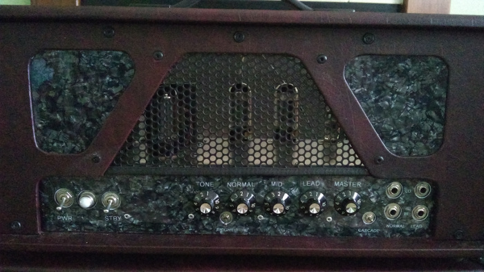

I'm not quite happy with the Lead channel, but that's because of the way I designed/wired it. The 'normal' channel has the Tone, Mid, and Bright switch, then Master Vol, while the Lead channel just goes right into the Master Vol>Poweramp without Tone controls. I did wire in a switch to cascade the Lead into the Normal, which brings the Tone/Mid controls into play, but then it's a bit less 'Blues' and a bit more 'Lead Gain'. For my desired tone, I probably shouldn't have done the Marshall-style tone stack on the Lead Channel....I think I would have more than enough gain with the cascade of the two normal channels. That said, if I put a Mid-cut control in the Lead, it might bring me back to my head-banging youth...LOL.

Yeah, I'm not sure how pure it would sound compared to a normal 5E3...There's quite a few mods I did that would have 5E3 purists reaching for the pitchforks...
Normal channel tone stack and tone control is standard 5E3, Mid-cut control should be close to 5E3 when on full.
5E3 Bright channel is basically Normal but adds the Bright Capacitor. I have it switchable and added to Normal Channel.
Lead channel has a Marshall high-gain tone stack, adds a lot of gain, and loses the huge 5E3 low end.
I split the channel preamps...the original 5E3 has a weird/cool interaction between the channels..this is one of the downsides of doing the Lead channel mod... If I'm running through Normal, for instance, turning up the Lead does nothing on my amp (like a normal amp). On a standard 5E3, the non-used channel volume actually does stuff.
I can still use a jumper between channels and mix the two channels.
The cascade switch runs the output of the Lead channel into the input of the Normal channel..so in this mode, it's really high-gain. It's still using a 12AY7 into a 12AX7, so it's not as high-gainy as modern high-gain amps, but more than standard tweedy amps. It also adds back the 5E3 low-end with the high-gain as well. I have considered swapping in a 12AX7 for the 12AY7, just to see what it sounds like.
The 3-way negative feedback switch takes output signal and brings it back into the preamp section. This lowers gain and cleans the amp up a lot. I prefer the mid position, with no negative feedback, but no cathode-bypass capacitor. The amp doesn't break up as quick as a 5E3, but it sounds a lot better to me, especially with pedals.
Effects loop is just bypassed when nothing is plugged into power-amp in.
Closest to standard 5E3 would likely be Normal channel with Mid control on full and Bright switch off, the Negative Feedback switch in 'normal 5E3' mode and the Master Volume at full. It's over the top...like the original 5E3.

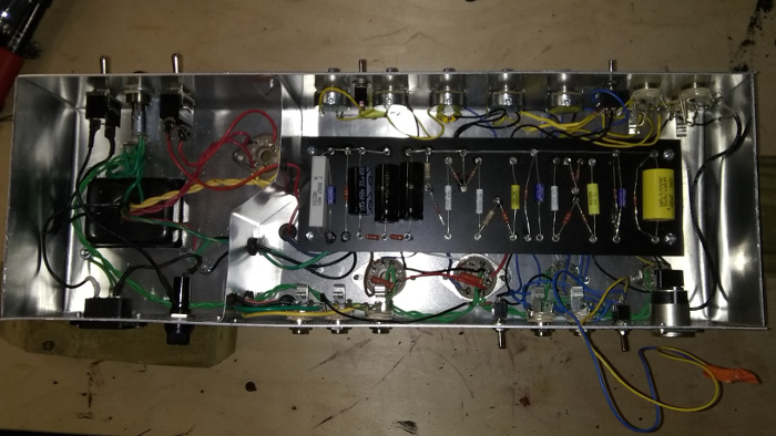

I've also added a bunch of safety/durability wiring and component changes over the standard 5E3, but those (hopefully) would have a negligible effect on tone.
