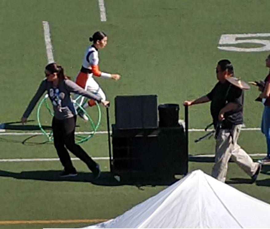

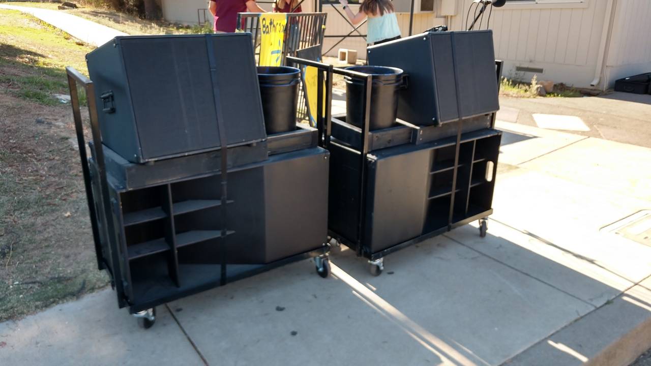

Last year I met a gentleman in our division who set up a pair of T39's and Omnitop 12's for their school. He said the system worked great but unfortunately I haven't had a chance to hear it myself yet. Our schools are close enough in divisions that I usually miss their performance because we're getting ready. He said he's on the forum so maybe he can chime in if he sees this. (pictures attached)

these are the photos of the T39 system:

If you are going to go the O15 route, why not make the cabs as per the plans, and just tilt the cab back? Doing that will keep them more multi-functional.

Tom Smit wrote: Wed Oct 23, 2019 9:34 pm If you are going to go the O15 route, why not make the cabs as per the plans, and just tilt the cab back? Doing that will keep them more multi-functional.
I think that's exactly what is in the pics Tom. The OT's look as though they are tilted, but actually they are in a frame of 2x4's (or 1x4?). The back of the cabs sits inside the frame. The front of the cabs sits on top of the front edge of the frame. Simple = smart.
