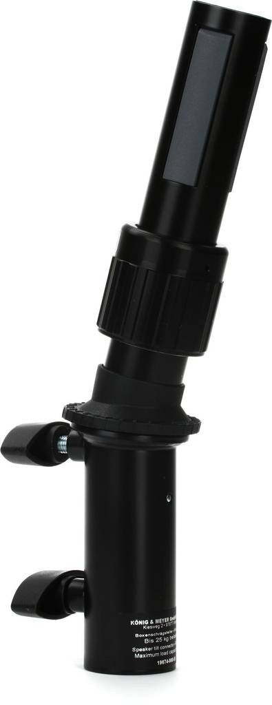

For bigger events (by my standards) I use full SLA pros on top of mini ones turned in a bit for center fill. I have a set of K&M tilt adapters (shown below) to give the little array a bit of tilt, but...an SLA on top of a mini is pretty tall and I get nervous about their stability when tilted.
Currently I'm using a stub of a speaker pole to connect the mini to the full size pro above it. Is there such a thing as an angled version of this? If the top was closer to vertical I'd worry less.
