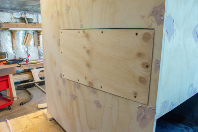

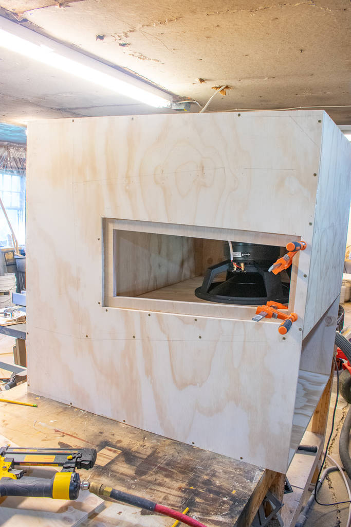

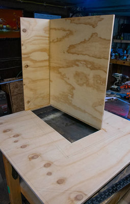

I read reviews, looked at specs, read and learned all I could for a few years. Finally settled on the THT. My original plan was to do the 36" wide version. About halfway through cutting the panels, I realized that the widest door in my house was 30.5".....so a 30" cab it was! This is my first post....on any forum. I have a background in woodworking, so the cabinet was super easy, and fun to build! Cut and assembled in 3 days. Let sit to dry for a few more days. Got it in the house with the help of an appliance dolly, and some grit. I'm amazed....and am planning a 2nd one as I type this. 2x Tlah and 1x curved sla in "parts ordering" phase now. If you guys like this build, I'll post the build of the others as well. I can, and have, spent all day just looking at other people's builds!

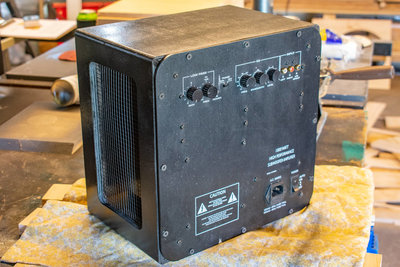

I had a plate amp laying around(Dayton SPA1000.....overkill, I know), so I used that for now. I had looked online for examples of "cases" that people had made for plate amps. Not much out there- So here's mine! I used 90-degree Speakon connectors for the cable between amp and sub. Works pretty slick!

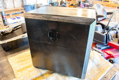

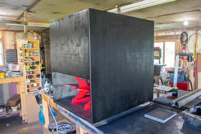

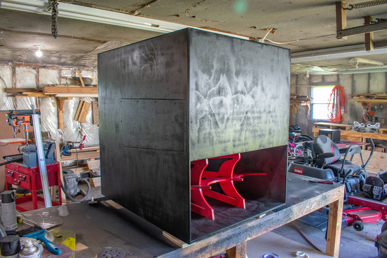

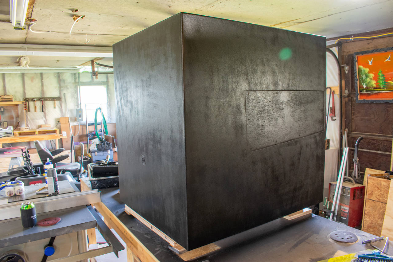

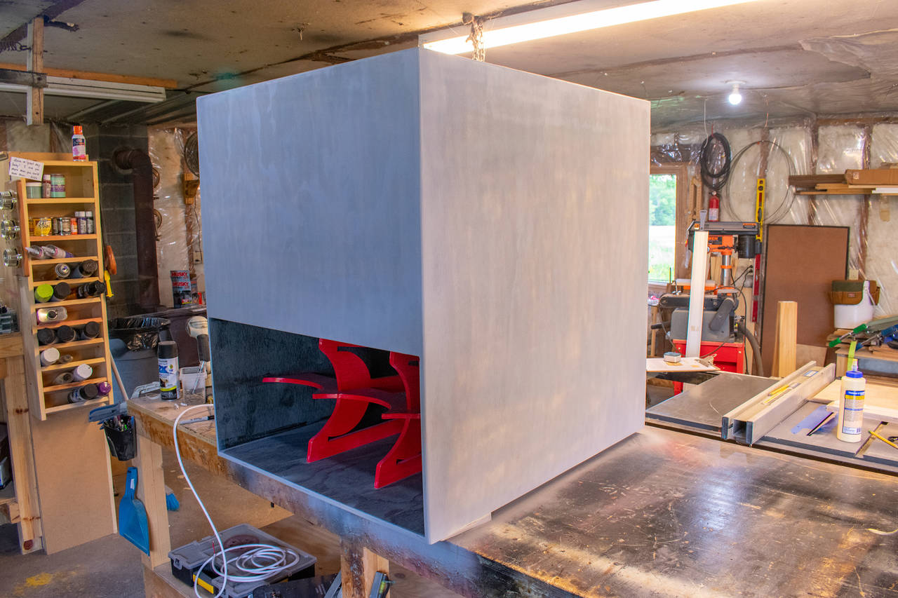

Here's the "finished" product. The pictures are before I re-painted the exterior....again. I sprayed a good filler/primer from a rattle can, then sanded smooth when dry. I tried to get by cheap and got a couple of those "Hammered Finish" cans of spray paint, in a dark pewter color. It gave a nice texture(like Duratex or spray-in bedliner), but is so THIN that I'd have needed about 15 cans to cover the grey primer. That is the stage it was at in the pictures below. I then rolled on a very good satin black cabinet paint. Not it is....well satin black....with a nice small "orange peel" texture to it. Not shiny grey with 50% coverage as the pictures indicate! Hope it is up to the standards I've seen here in the past! Thanks for the great product Bill!!

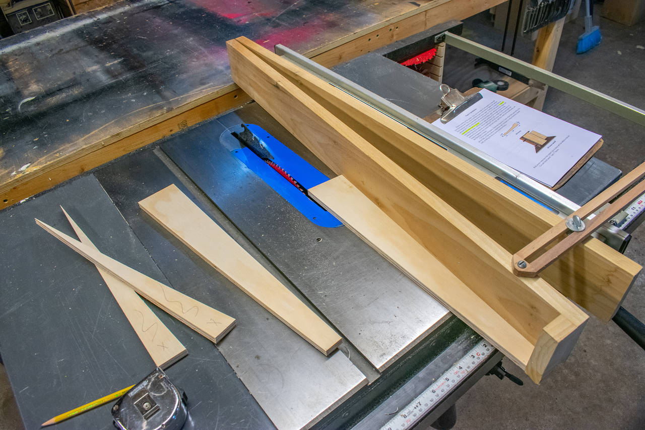

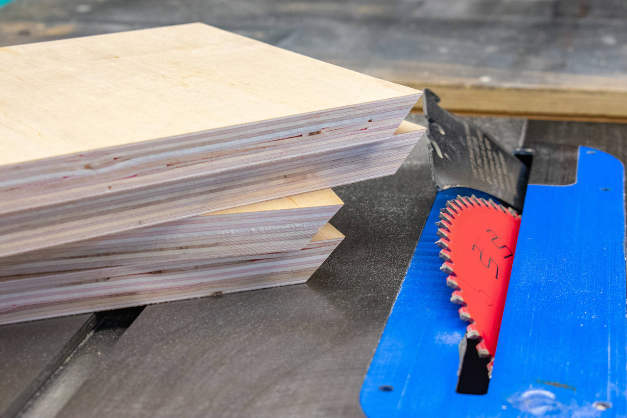

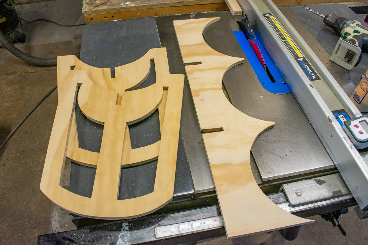

Also, I love how simple your table saw angle jig is. I may have to steal that idea.

Thanks! I scoured the internet for a "diy" taper jig for my tablesaw! You can buy them, but they're kind of pricy! This one works- made from kiln-dried poplar. So it's nice and straight, but stiff enough to not bend under stress of the blade!
