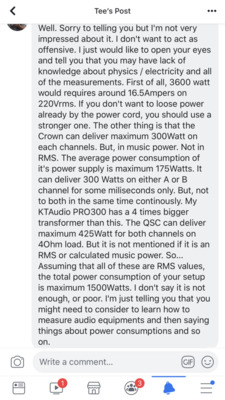

This is feedback that I got from a guy on Facebook about the YouTube video I recently posted here,any logic in what he’s saying ?

Hard to say without context. Did you claim you had a certain amount of watts or something?

No Seth,the guy seen the video I posted and his response is what I copied and pasted above.What I need to find is some type of guideline that will allow me to add up how much power I would need to actually run my system and have some headroom.

Well, some people like to blab about things in a way that seems to imply they're telling you something you don't already know. Pretty much, I just assume these people are at the limit of what they know themselves and are self impressed. I'm doing it now, see.djtrumptight wrote: ↑Tue Jul 16, 2019 4:04 pm No Seth,the guy seen the video I posted and his response is what I copied and pasted above.What I need to find is some type of guideline that will allow me to add up how much power I would need to actually run my system and have some headroom.
But on a serious note, your generator claims to be able to provide 3600 continuous watts. 3600watts / 120volts = 30amps
A point that he brings up, is that you wont be able to squeeze that much amperage through the extension cord you're using without voltage drop and potentially melting it and fire.
However, It's kind of moot point. I don't think you would need anything more than 12g for up to 100' for the equipment you're running. AND, it makes little to no difference that it's a cord plugged into a generator or a wall. I can't tell the gauge cord you're using, but it didn't look anemic to me. If it's a cheapo 16gauge, toss it and get a new one. 14ga should be okay for up to 50'. I'd just get 12.
Funny thing is he essentially said the same thing in a very self inflating manner. Block that trollish guy from your facebook. You don't need that shit. Good on you to look into it though
Just my opinion on it anyway...

Old mate is right (FOR 220V)
With 220V and 3600W, amperes are 16.3.
Let me guess though, your generator is 110V, and 3600W at 110V is 32.7 amperes.
As to working out how much power you're pulling, is your generator stalling, throwing breakers or otherwise failing?
If the answer is no to any or all of these, then your rig isn't pulling as much power as you think...

If you look at the specs posted for current draw by amp manufacturers it's usually stated at 1/8 power. That's because amp manufacturers are aware that's as much continuous power that an amp is likely to be run at. QSC, for instance:
1/8 power represents typical maximum operating conditions
1/3 power represents over-driven program levels
Full power is breaker limited to short periods
While your facebook troll may have a cursory knowledge about physics/electricity and all of the measurements, by no means is he as smart as he thinks he is.

Everyone above is right.
I'll throw in as well. Your gennie is fine. I've run a lot more off of my Honda EU2000i 2000w gennie (just a bit less power than a standard 15-amp wall plug), and I've run tons more than that (full stage, projector, some LED lights) off of two EU2000i gennies (my PA on my genset, the stage and assorted crap on the other...I didn't have them linked).
I also run mostly 12ga cable (other than IEC cables, etc). I used to work for a couple audio production companies that ran all 10ga cable minimum...heavy duty for sure.

Ok,thanks fellas,I was thinking I was missing something the way the way this guy was talking.My power cable is 12/3 sjoow that corona operator suggested I go get.
