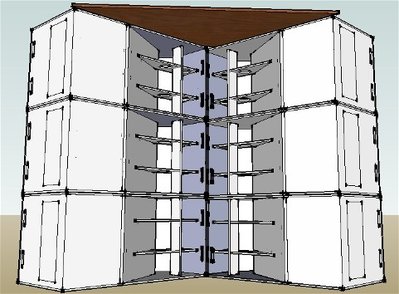

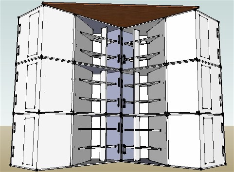

I just read through the subwoofer placement post, and found it really helpful. I did wonder if all horn couple plates are applicable to regular subs with sealed/vented configurations. I have 4x 18" subs at my disposal outside, and wondered how I can get the most of them. I was thinking about a square with the 4 of them, and was wondering if a plate an "v formation" would help.

I'm probably wrong, but the way I see it is, the V plate is about creating a larger mouth area.
That makes a different in horns.
I'm not sure it does for DR's though.
But wall loading and corner loading will, if you're inside.
The best you could do would be to make sure the 4 cabs are stacked together for coupling..

Yeah, coupling them is logically a thing, but as it wasn't specified further I was "hoping" the hornloading with a plate would help. As you're saying, it would expand the horn mouth area, but as there is no horn to start with I think you're right in thinking the horn you create with the plate would not be big enough to support any low frequencies. Just wanted to be sure.
Re: Couple plate and front firing
I think that v-plating does positively effect the situation ie better impedance matching effect. but how much in that situation, I’m not sure. If it were me I would try to experiment by finding something, a sheet of wood or something and see if a plate helps. If it does I would be inclined to build a v-plating system for the sub bank.

Correct. Even if you added a three foot long horn to the 18s it would only load them above 100Hz, where they're not working anyway.

Coupling plates and 'fake corners' only have an effect if they become long enough right? 1/2 wavelength? Or? And how does the mouth area come into effect?
