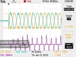

NukePooch wrote: Fri Apr 19, 2019 2:50 pm one weekend event (that happened to be run off my generator). I couldn't get any volume (not like it should have been, and not as loud as I could get when I tested at home. I thought it was a bad unit, so I sent it back to the store.
You won't get any power from it (nx6000) on a generator because of no power factor correction. It sucks it's power in 80 amp gulps rather than a steady state draw.
(power draw in purple at the bottom, each tick on the vertical is 10 amps)
A generator can't rev up the rpm's fast enough to keep up with the varying draw. They are shore power only amps (and do a pretty good job if used that way).
The nx6000 is too much amp for T48's, It puts out ~97 volts, too high for these cabs.
