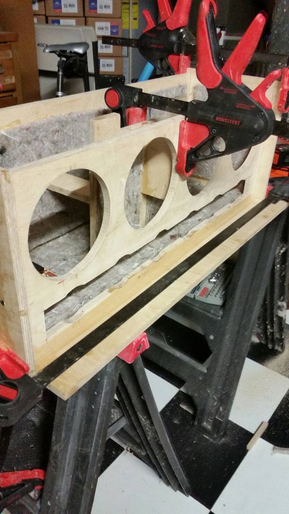

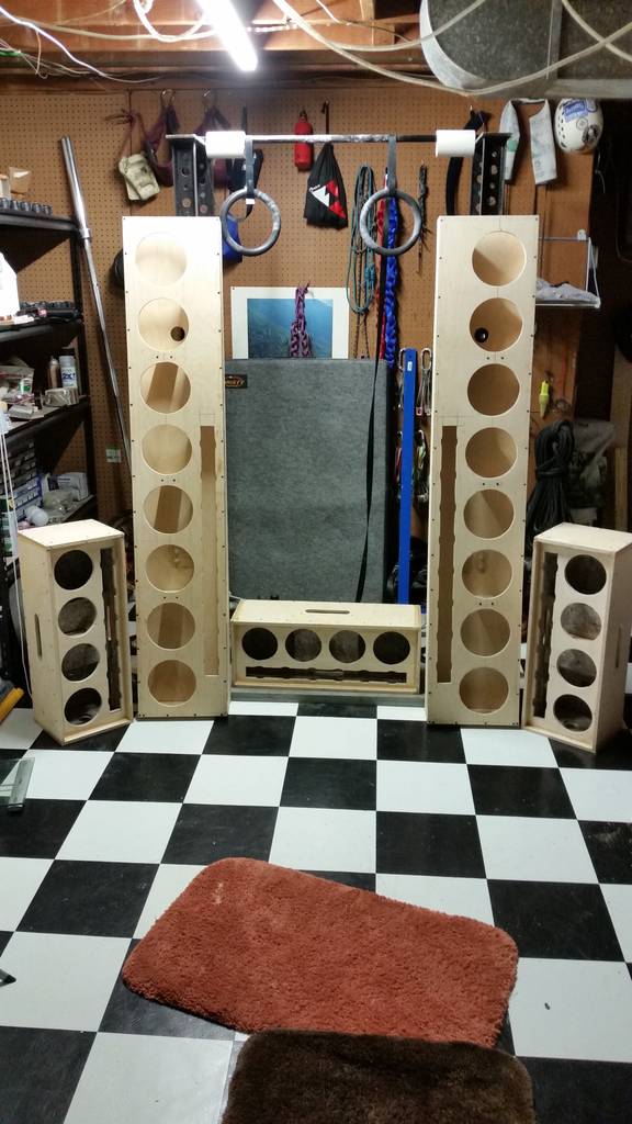

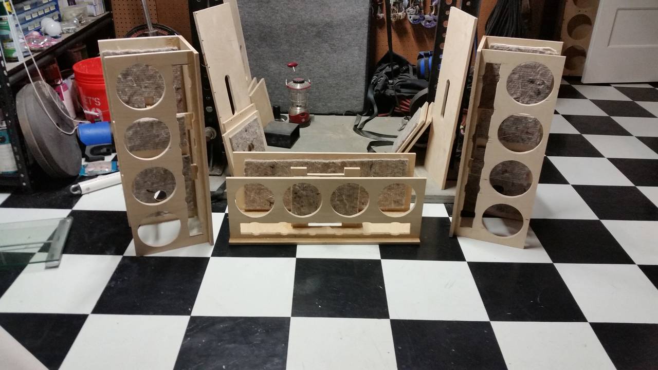

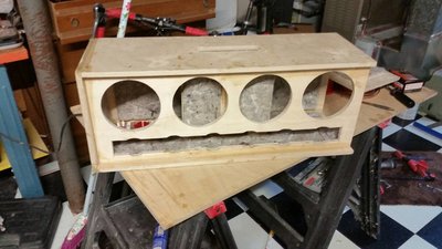

Meet Anna 1, Anna2, Anna3.
Better known as rear left, center, and rear right.
If things go well, I'll be taking them to the finisher (along with the 2x THAH Pros) later this week.

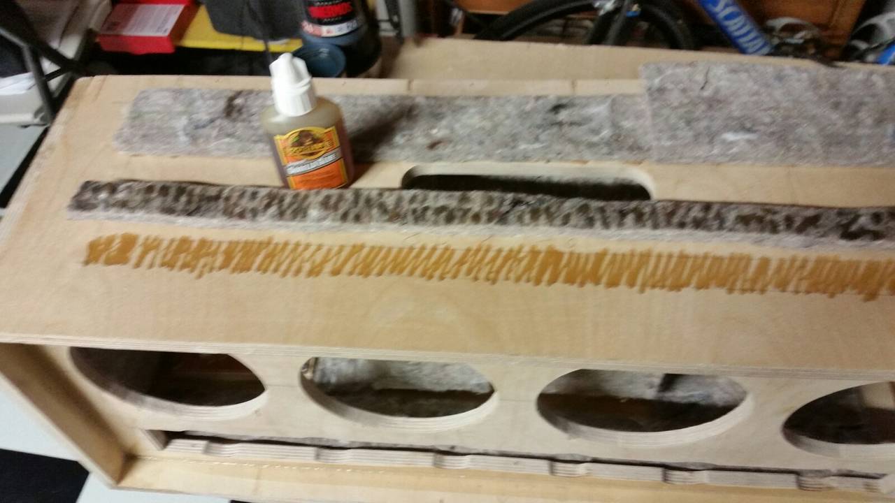

(Tip: don't put felt on the sides BEFORE you put the sides on, otherwise you might have to cut some off...which is a pain...cuz gorilla glue is really strong...)

Are you going to have that center channel laying horizontal like in the picture? If so, you will cut your dispersion to a small angle....that box is designed to be vertical.
climbikejk
- Posts: 53
- Joined: Sat Dec 18, 2010 9:29 pm
Re: ...and 3x SLA Pros to go with them
Hey Bruce. Fair point. I went with the Pros (straight) instead of the non-Pros (curved) because I was willing to sacrifice dispersion angle over SPL/freq range. The left and right Pros have pole mounts in the bottom pieces. Anything I make will be better than what I have ( <-- that should probably be trademarked for this site)

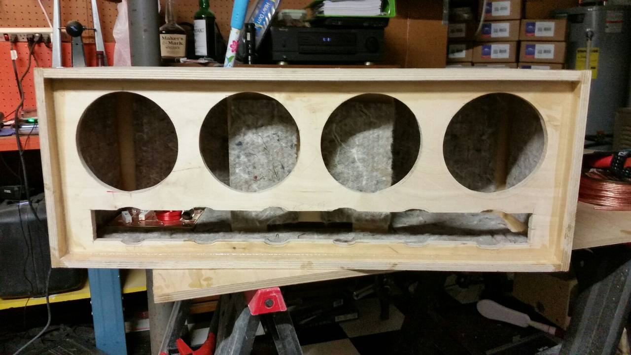

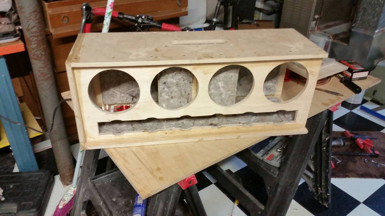

It's so nice when you finally have time to put into your projects.
I think Gorilla glue should send me a Christmas card.
Almost done....
Finally, the first (of three) is done! The other two are close behind.
Almost done....

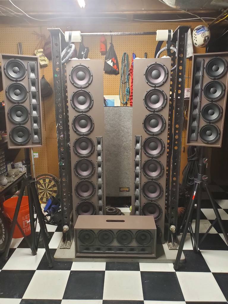

Yeah! The family's all here! They're going to finishing school later today.

Nice finish.
climbikejk
- Posts: 53
Thanks. I wish I could take credit, but I can't. Wife chose the color and "A Perfect Finish"....finished them.
