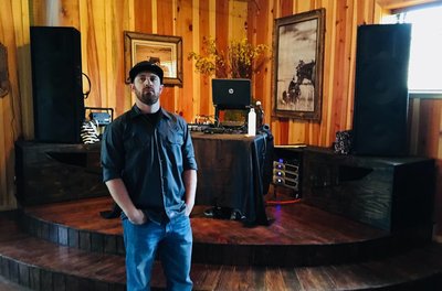

I have had a few situations where splitting my subs has been advantageous. Some smaller eccentric venues allowed me to power alley and get high energy on the dance floor while somewhat canceling allong the walls of the venue. This picture was one of those places where I did split the subs a little bit. And I had all the power in the world where I wanted it and back where the chairs were it was somewhat attenuated. When I couples the subs together in this venue the roof rattled “tin roof” real bad at the location of the subs. the rattle was somewhat mitigated in the shown configuration. I do however couple the subs together whenever possible (most of the time)or at least I try that first when setting up.
