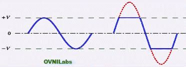

Not that it directly affects you, but it's worth noting that this doesn't necessarily make you safe. When these idiots start redlining gear (which includes playing hard into the limiter so it's always limiting), they start driving the power curve up so you end up getting more power per volt. Bear in mind that when we do these equations for watts and volts and power there is an assumption that you are calculating RMS power. As you increase signal into a limiter or a clip point, the waveform gets squared off, meaning you get more power dumped into the driver without more volume. The effect is distortion of the signal.CoronaOperator wrote: ↑Mon Oct 01, 2018 4:27 pm
EDM DJ's never have enough.
I since wired them series so that even if they disable the limiters:
A: only 1 would blow instead of both at once as that would open up the circuit (they are dual loaded cabs).
B: the amplifier only puts out 97 volts so each driver is only seeing around 48.5 volts - within their limits.
That has held up over a year so I think they are safe. If not, not my problem - we sold the club Sept 1st and they were too big to take with me so I left them there. I'm going to build single T45's so I can move them around more easily.
On a graph power (watts) is represented by the area under the curve. This comparison shows a rather extreme example of this... but the type of example that would cause speaker damage in the situation described above. These two signals would show the same on a SPL meter, but they certainly wouldn't look the same on an RTA or sound the same. In this chart, the X axis is time and the y axis is modulation in volts. Power over time is represented as the area under the curve. Say these two snippets represent 1/50 second each, which would make this a 50hz sine wave. It is clear to see that the clipped signal delivers far more power (again, power is area) than the nonclipped signal at the same voltage.
This relationship of power to voltage and clipped signals is the source of the "underpowering blows speakers" myth. People will take a speaker rated for 500w, power it with an overdriven 400w amp, and end up delivering way more than 500w of power to the speaker causing thermal damage. They then assume that since their amp says "400w" in its specifications that 400w is all the power that amp can deliver, and wrongly assume that they have "underpowered" their speaker, and that killed it.

Excellent point on how peak limiters can lead to overheating of the voice coil if driven hard into them. I think they are still safe, all 4 drivers are being driven off 1 amp channel and I don't think the power supply of the amp has enough juice to drive all 4 of them into thermal overload. If they do I guess I get a service call

I thought limiters left the signal intact. Like compression, attenuates signal peaks. No?BrentEvans wrote: ↑Mon Oct 01, 2018 9:34 pm When these idiots start redlining gear (which includes playing hard into the limiter so it's always limiting), they start driving the power curve up so you end up getting more power per volt.
