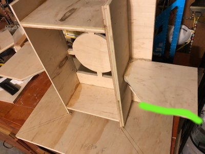

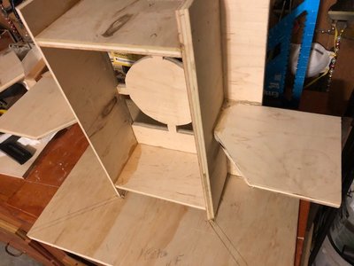

I am building a Jack 12 for my bass rig. Everything was going along as expected till I wanted to install the horn braces. Oh, I got them in the center and all glued and tacked. Now, on to the Mouth Panel and the question.
Are the horn braces supposed to NOT touch the Mouth Panels? My Horn Braces stop about 1.5" from the front edge of the Throat Assembly. Are the Mouth Panels supposed to attach to the Throat Assembly with no additional bracing? . Did I do something wrong? I have checked and rechecked my measurements against the plans.
I have good shots of what I am talking about.
Any suggestions?

You installed them facing the wrong way. From the plans: Cut two horn braces for a 112, six for a 212. Write on them how they install per the diagram. I can't see anything written on them.

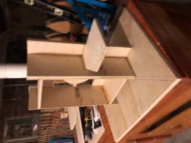

I compared my pic to the plans. What is the problem?

I have one of those saws. I am still unclear as to what I did wrong based on the plans and my photos.
If I glued them facing the wrong way, what way is the right way? I am not trying to be difficult, I just don't understand what is wrong.

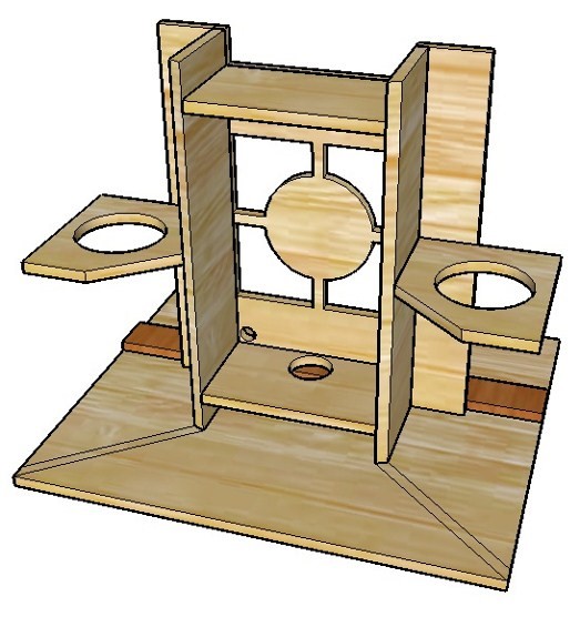

Look at your scetchup model. It looks like you didn't make them big enough.
They need to go right to the edge of the vertical piece so that it will attach to the horn when that gets installed.

OMG,,,, I see the problem..... I cut the angle out on the wrong edge. The way I have them, the braces stick out past the bottom of the cab..
I feel more than stupid right now.
Thanks... Hope I did not mess anyone up.

The "green" edge should be against the throat panel, I believe.
