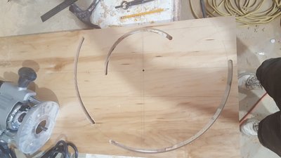

I start with templates of the curves:

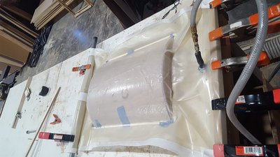

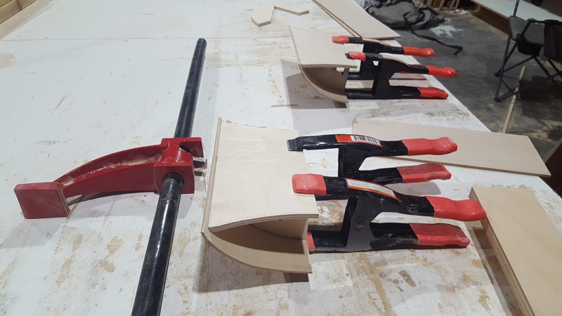

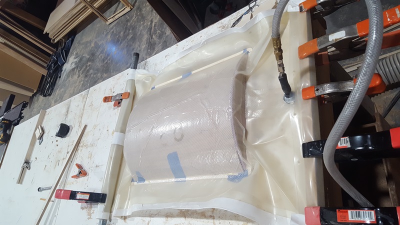

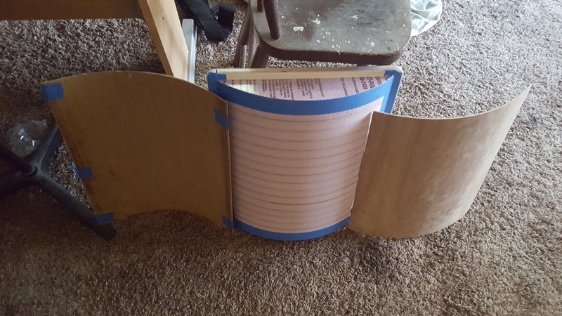

The panels were made from 1/8 luan with cherry on top, 3 layers each sanded to .040 before pressing, I used titbond 2 for the lamination.

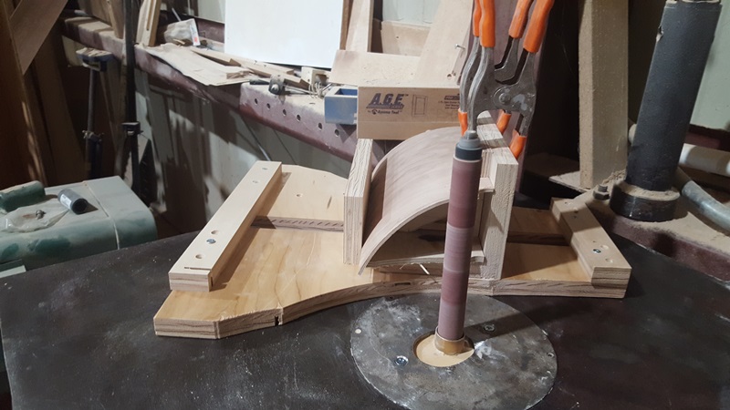

Sled to trim the curved panel
In the bag
In the bag
Finished mould and panels
Creating the moulds for the press

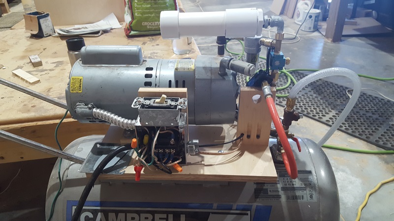

pump almost done
pump almost done

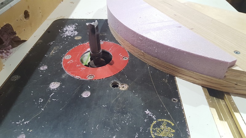

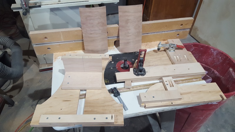

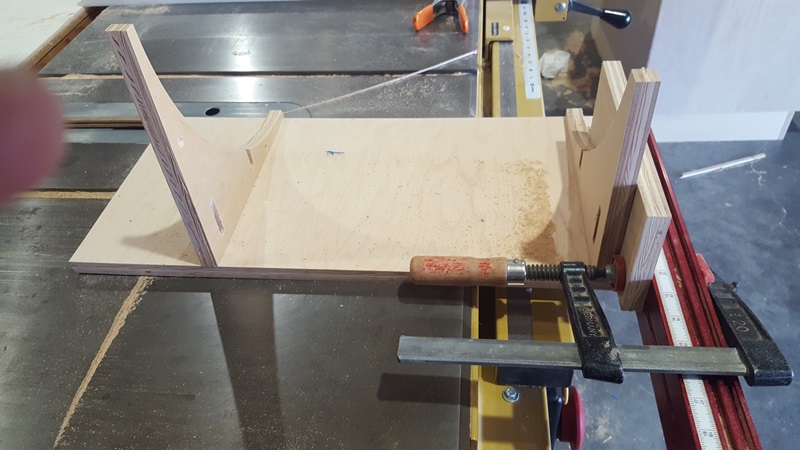

More jigs:
Duct side cutter, the carriage is adjustable side to side to slowly get the fit right.

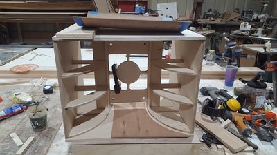

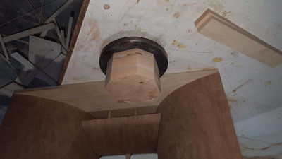

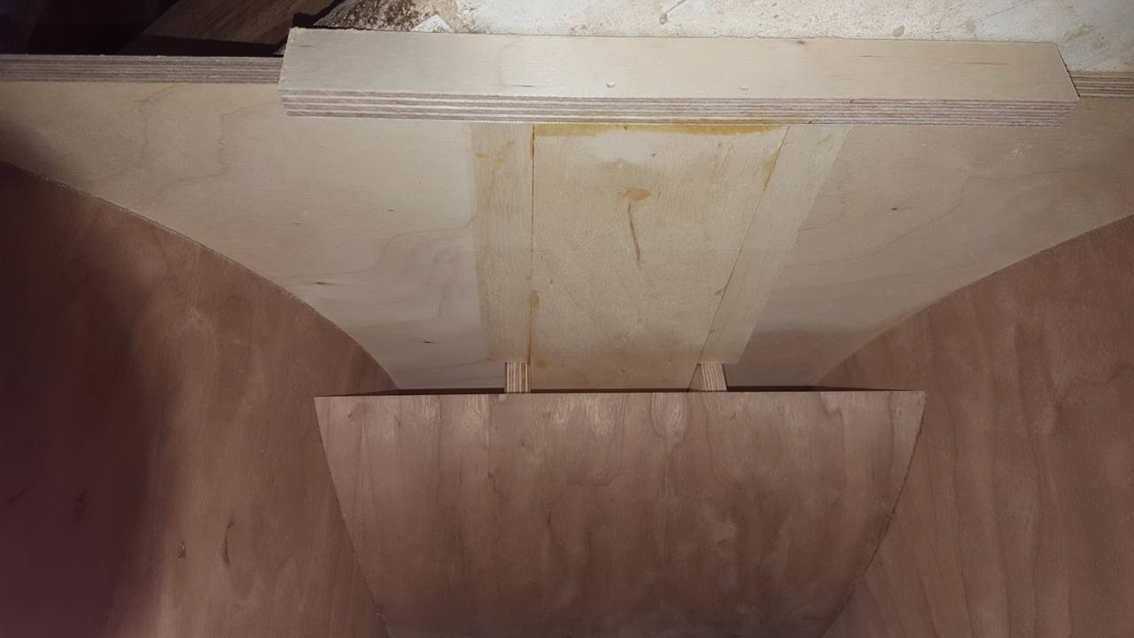

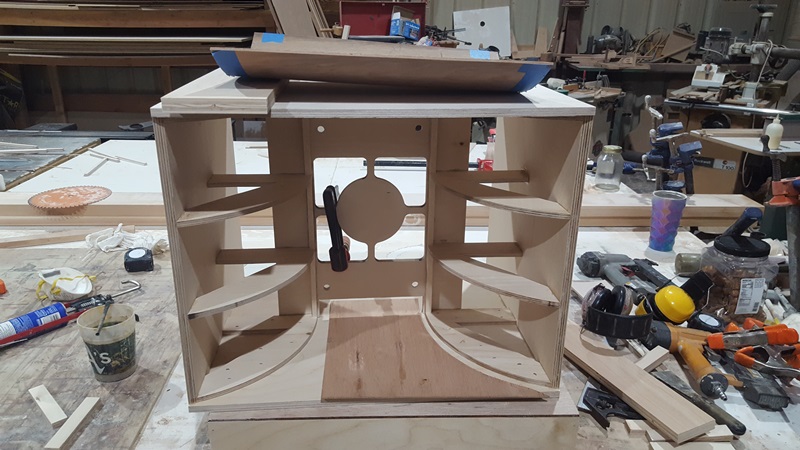

Coming together, I did add some braces to help the horn sheath attach, every thing was done with a few pin nails.
Different order here, I glued the ducts together first, here the braces go on, this is the jig they will be cut on, so the braces are attached with the help of the jig, this will index later.
Small panels and jigs

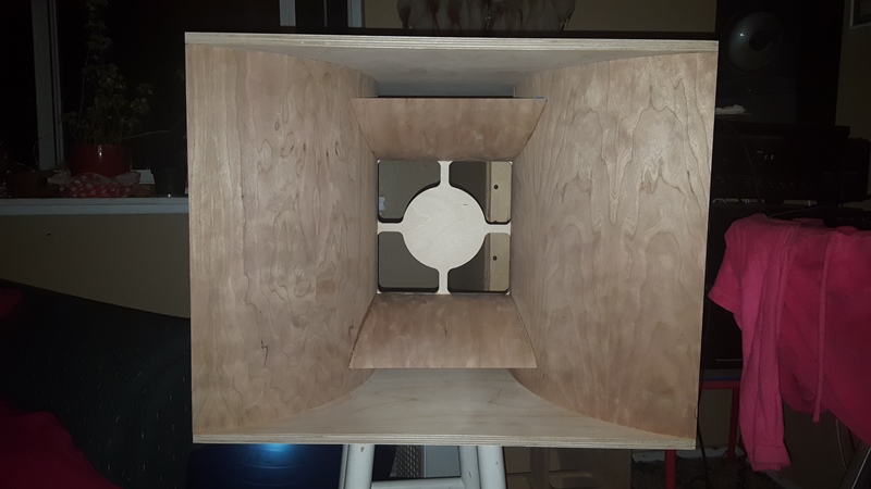

Current state of the build, hard parts done.
Current state, my first duct install got a little glue stain, the second I kept under control and was clean.

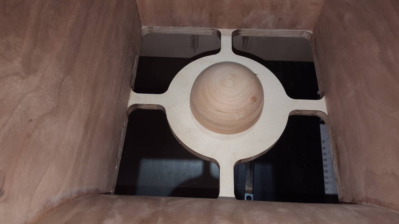

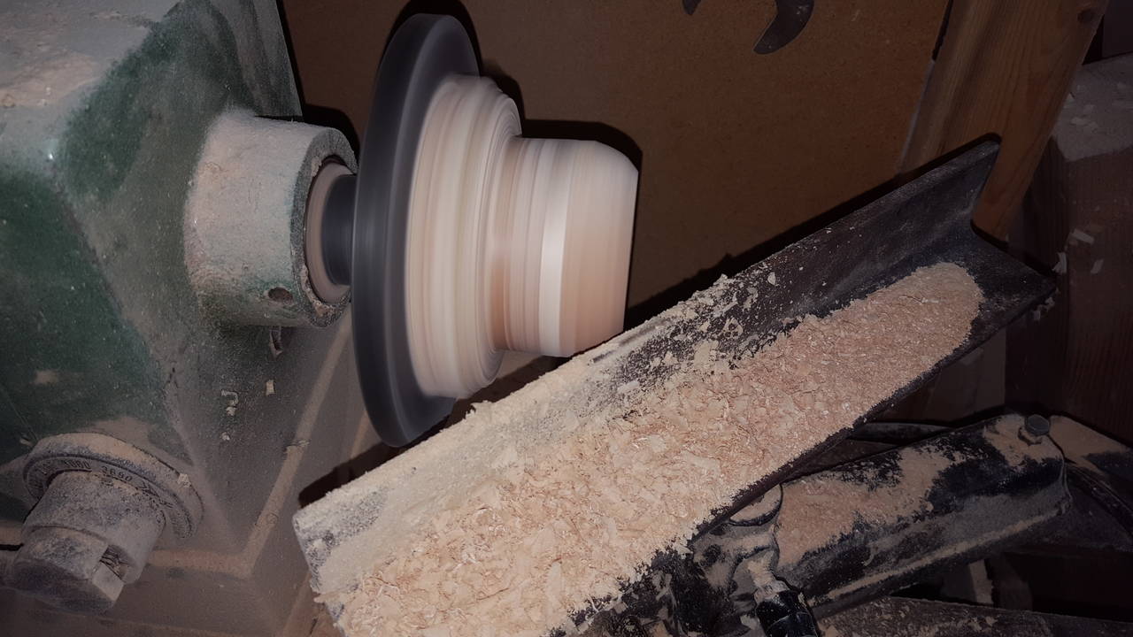

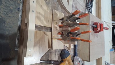

Back to work this week on this project. Some new braces and prepping for the lathe. Pics all were right side up when I selected them.
gonna turn this thing on the lathe for the 3"semisphere, two cherry layers with 1/4 maple in the middle

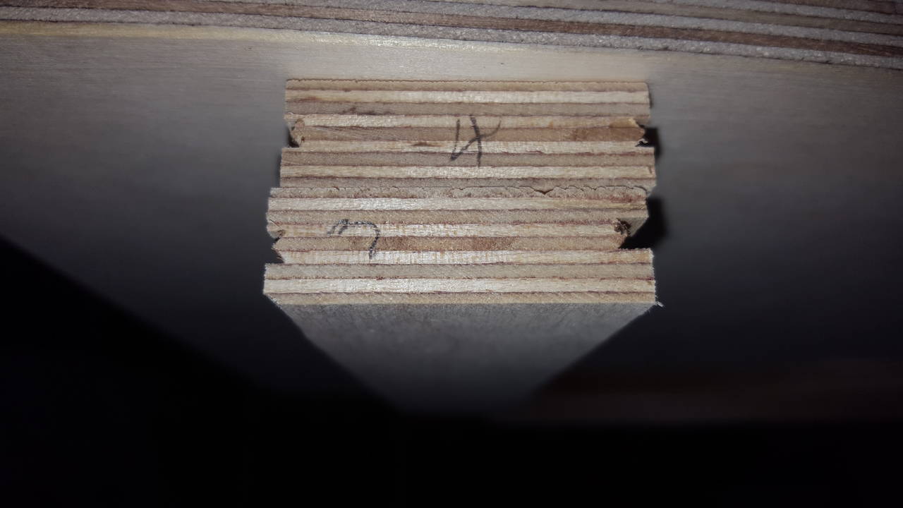

I put little kerfs in them so the glue would stay in place and expand after sliding in.
setting these braces, little jig to help place them.

Messed with the lathe today, kinda scary in the beginning but I got the hang of it well enough to make this happen. I got the 3" on the money but the height is 1 9/16ths.
made a 3" cylinder on the lathe
then made it round.   cherry with 1/4 maple in the middle.
