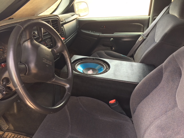

I have just finished up an AutoTuba with the 8" MCM driver at 14" wide. This sub cab is in my 2002 gmc pickup truck extended cab. This subwoofer is replacing a light duty 10" direct radiator bass reflex 1.25cuft 34hz tuned enclosure consuming around 400watts. I am powering the AT off of an old school USacoustics 2075 amp, bridged is not much over 100-150watts ish. Basically based on everything I have learned here it is a no brainer, but I will elaborate anyway. Basically this AutoTuba destroys the old setup in everyway, it is more efficient using 1/4 the power, it pretty much plays out flat to 20hz where the other setup fell out after 24hz and became labored below 30hz, the old sub had a peak around 32-36hz for obvious reasons that took away its audiophile potential. with the new cab it is pretty flat across the board and the blend to the mid range drivers was easy to sort out, let it be said that I have some DSP in my head unit making integration pretty easy.
I made the old sub sound good and never drew enough power to stress the electricals, but I could have ran like a 10gauge wire for the amp I am using now!!! the old sub setup seemed to have nothing really lacking but this new sub is truly better. The sounds are correct, smooth, tight, sharp (when supposed to be), theres less shakes in the cabin but more pressure is perceived. perfect perfect perfect, the box is a little bigger than the old one but not by enough to make the switch any less desirable.
look I am posting this up to directly compare a typical car setup to the AutoTuba. The AutoTuba is better by a lot if you can correctly fit it. I will not only recommend it but try to convince everyone I know who is in the market to let me help them build one.

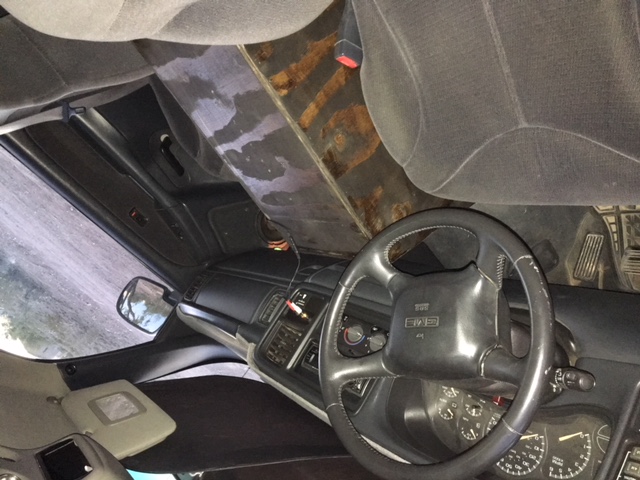

Re: Auto Tuba Review
flip the pic over
bloody hell flip over!!!

well I cant get the picture to invert, sorry about that, basically I removed my center consul a while back for fun, then got the idea to build an AT and put it as my center consul, so I put my sub in a similar shaped box and placed it in the truck where abouts I would be putting an autotuba, after deciding that the spl was about the same in that spot as having the sub under the back seat I decided that an autotuba I would build. for under $200 and a lot of fun I have my sub in my truck and its better than I could have hoped for. once again sorry that the picture is upside down stupid thing cant get it to flip right ways up. well anyhow...

NICE! I also have an MCM autotuba in the back of my Buick Park Ave. They Rock! Glad your happy with it, and i love the center console idea!
