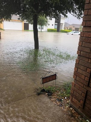

Today we were hit with a flash flood down here in the RGV and area was pounded with 15" of water in a few hours. We ended up having over 5" of water in the house and about 9 in our garage. Unfortunately I left at 7 in the morning, but my wife was able to get off of work and head home as tge water was rising. By 9:30 water was coming into the house. My newly built T39's were in the garage. Unfortunately one had the mouth facing up and the half the speaker got submerged with the rising water. About half way up to the voice coil. So I took out tye spesker and set it out to dry. What are the chances it is ok?

This was at 7:50am as my wife drove out

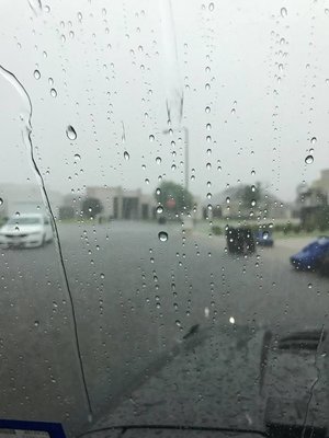

https://www.facebook.com/SpeedShed/vide ... 524242609/ This was taken at 10:15 am after she got home. You can see the water level on the white car change Let me know if there in anything I can do to hopefully keep from buying a new speaker
