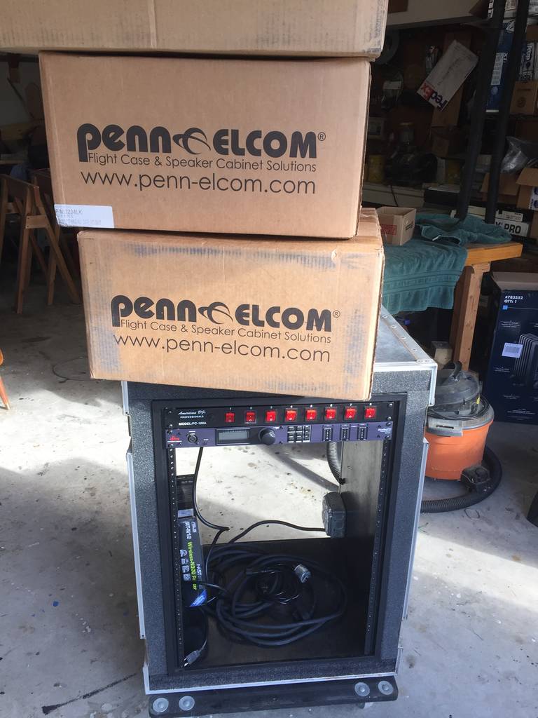

This is the rack that the owner picked up used for $200. 16U shock-mount - very nice and in great shape....even had a 4-gang power box at the bottom.

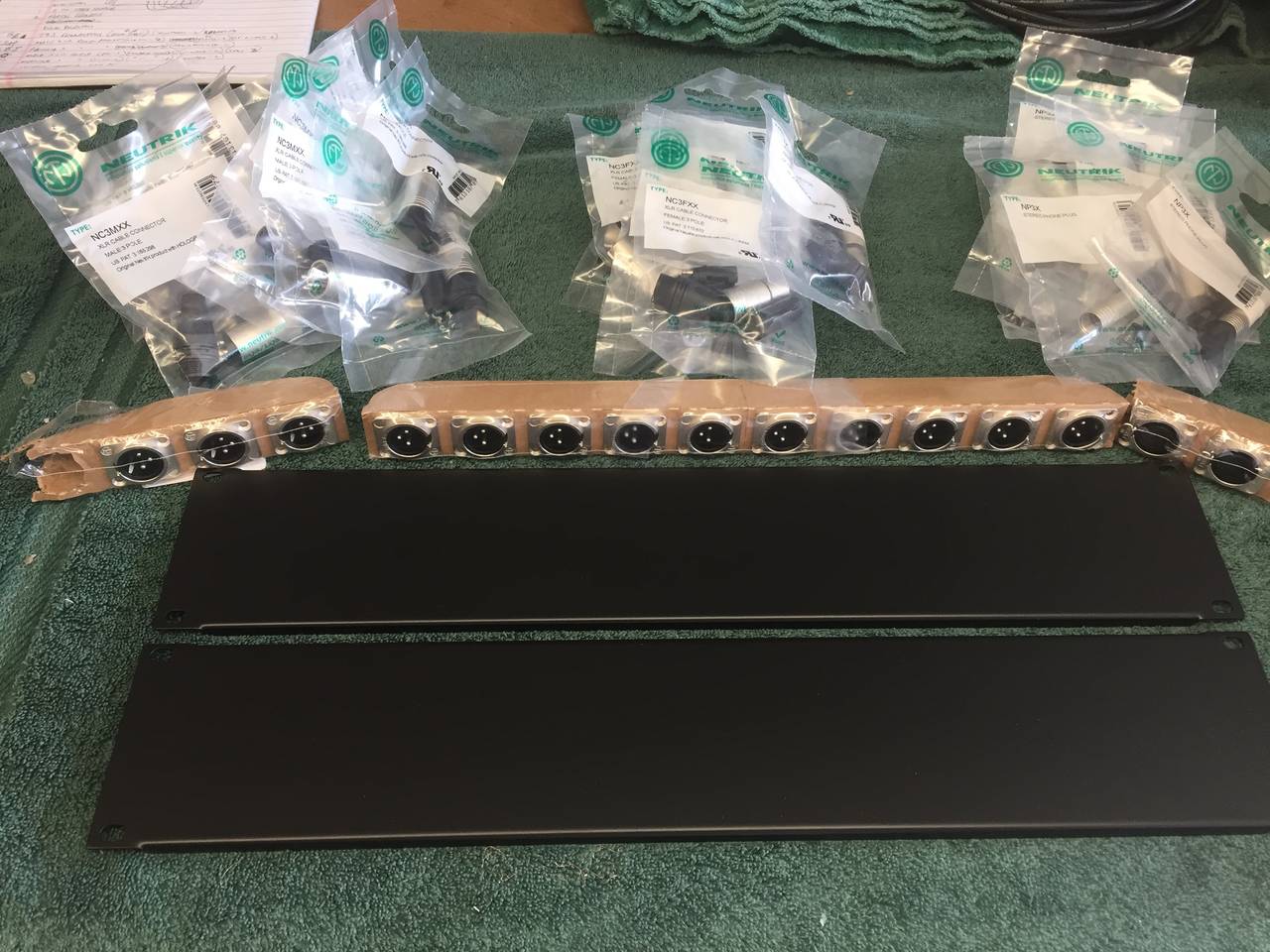

Take the time to draw out your plan and check it over and over and over.....then order your parts.
Steel rack panels with flanges. Don't try to use flat panels, they flex way too much.

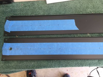

Once you've decided where everything goes, use some tape to layout your connectors. By the way, you'll notice that I always use 2U panels. The 1U just don't have enough room to properly label everything and it's really tight to work in there.

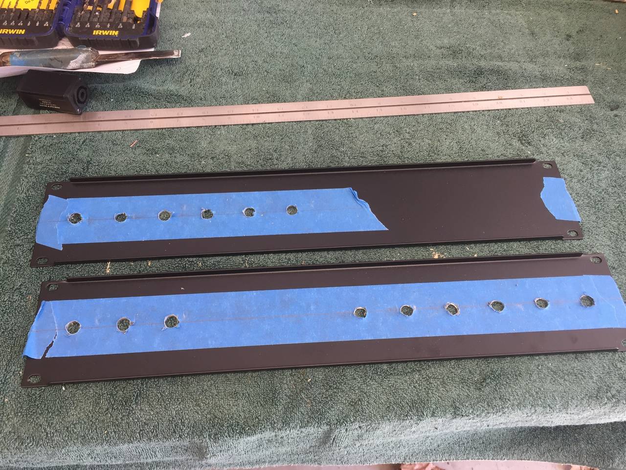

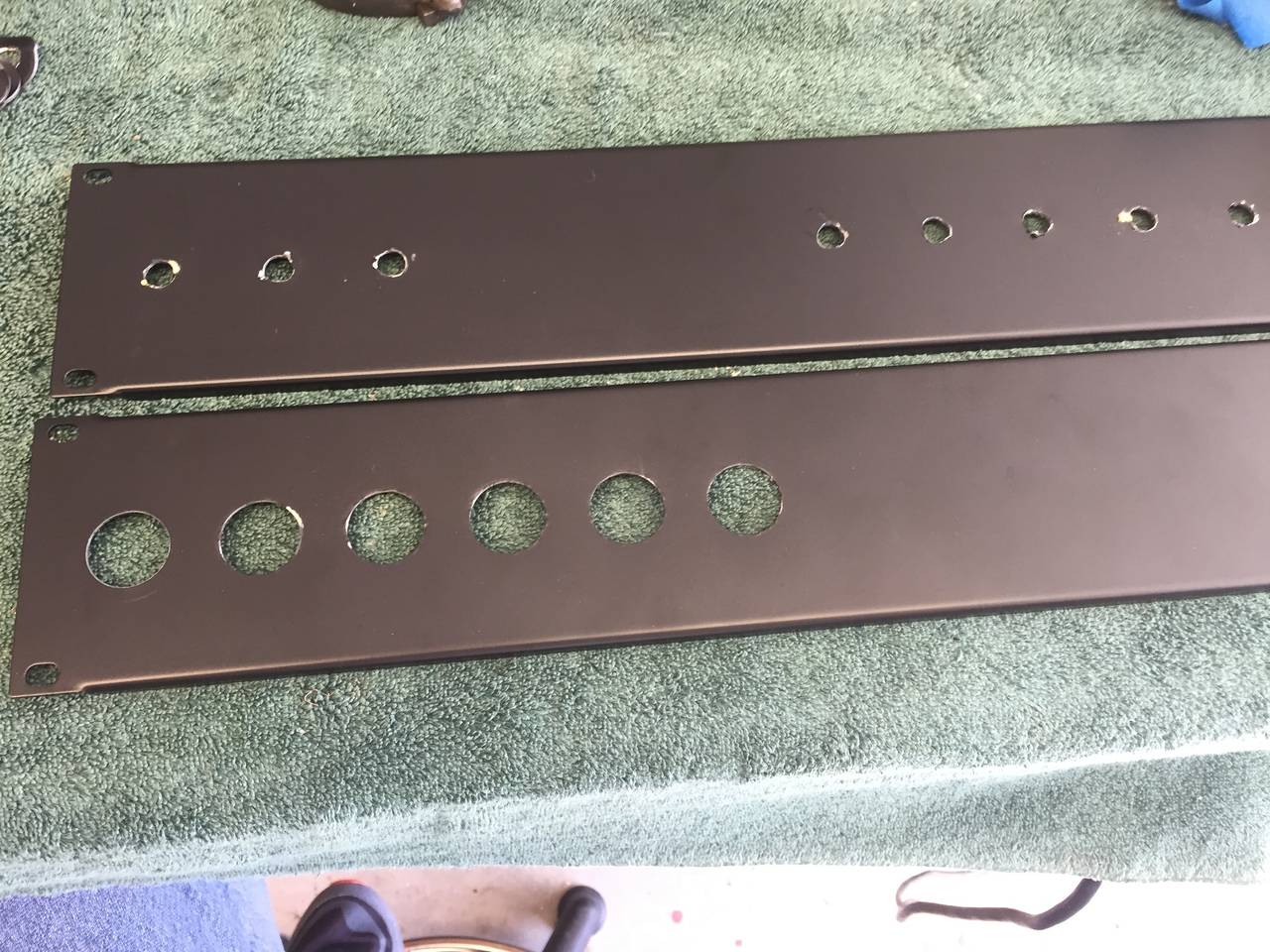

After putting a good dimple in the panels, they get drilled with a 3/8" drill bit.
- Posts: 8678
Re: How to build Rack Panels and put together a rack

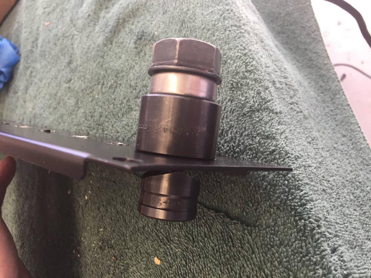

Next up is the knock-out punch. Put it in the hole and start cranking on the bolt. It makes perfect holes. The 15/16" hole is perfect for all of the D series Neutrik connectors - XLR, Speakon, Powercon.
- Posts: 8678
Here they are with some punched....

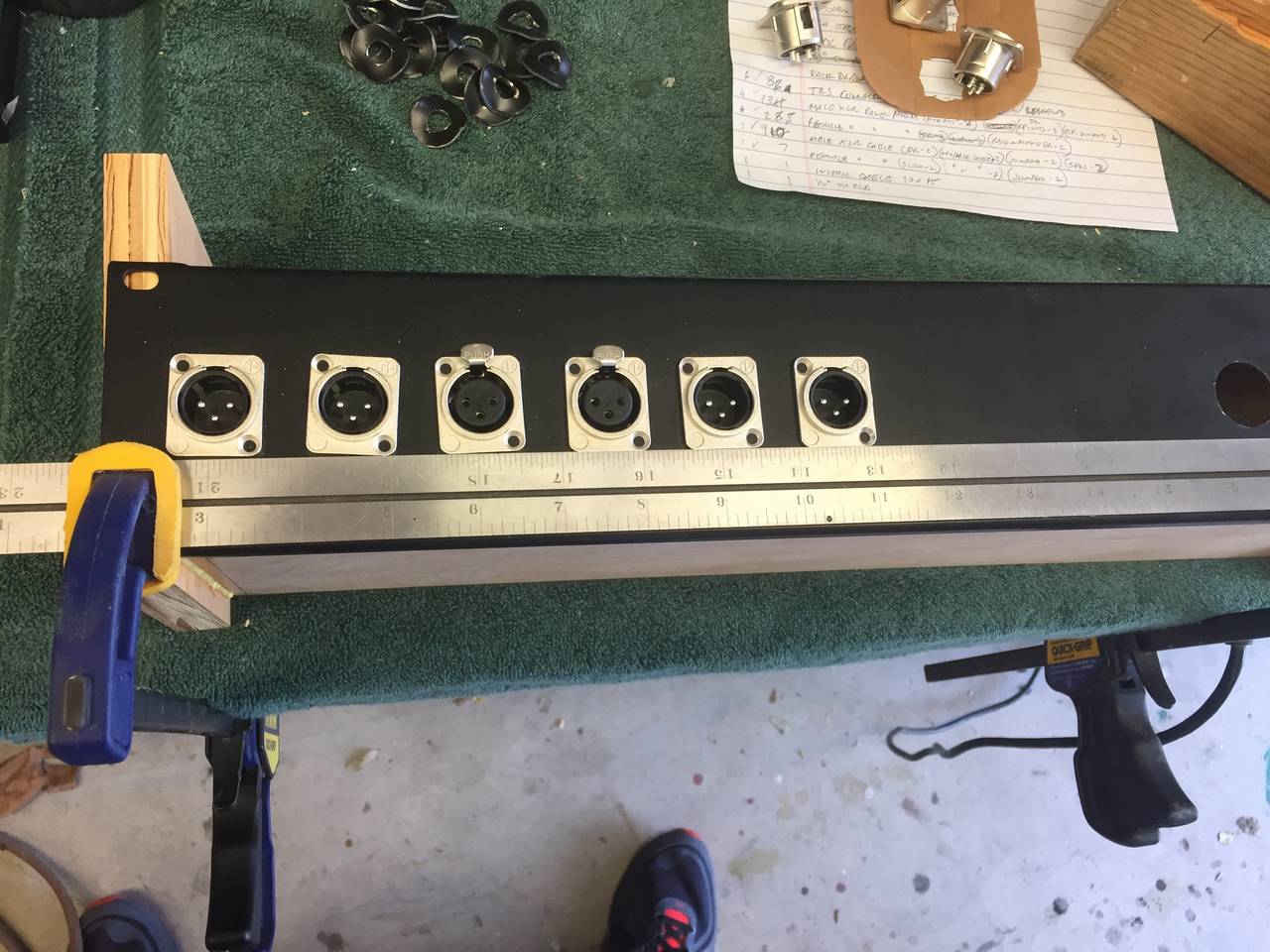

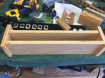

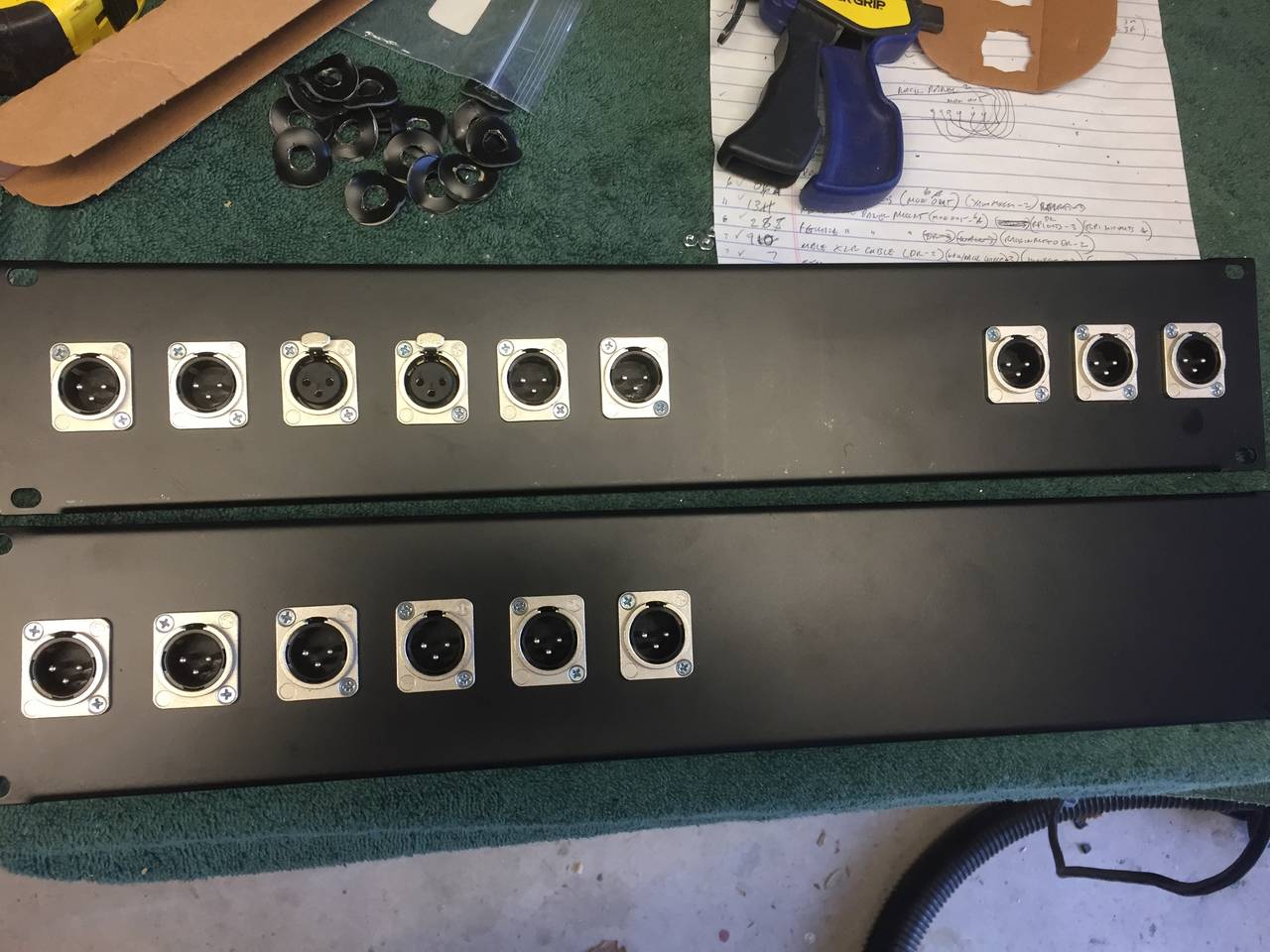

It's always been tough getting the connectors lined up perfectly.....normally, I don't worry too much about it, but decided to figure out a better way this time.
So, I built a down and dirty jig that allowed the panel to rest on top.

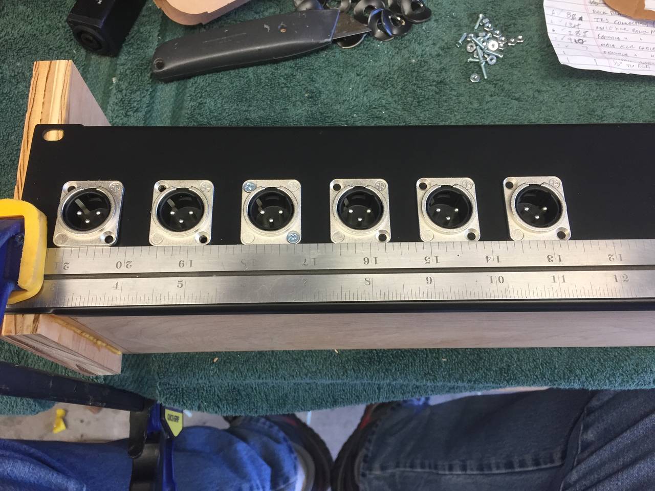

Then I used a straight edge to line 'em up and keep 'em square. With that clamped in place, I drilled all the holes for the 4-40 machine screws (available at Lowes and HD).
All punched and screwed down.....ready for cable....

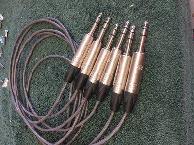

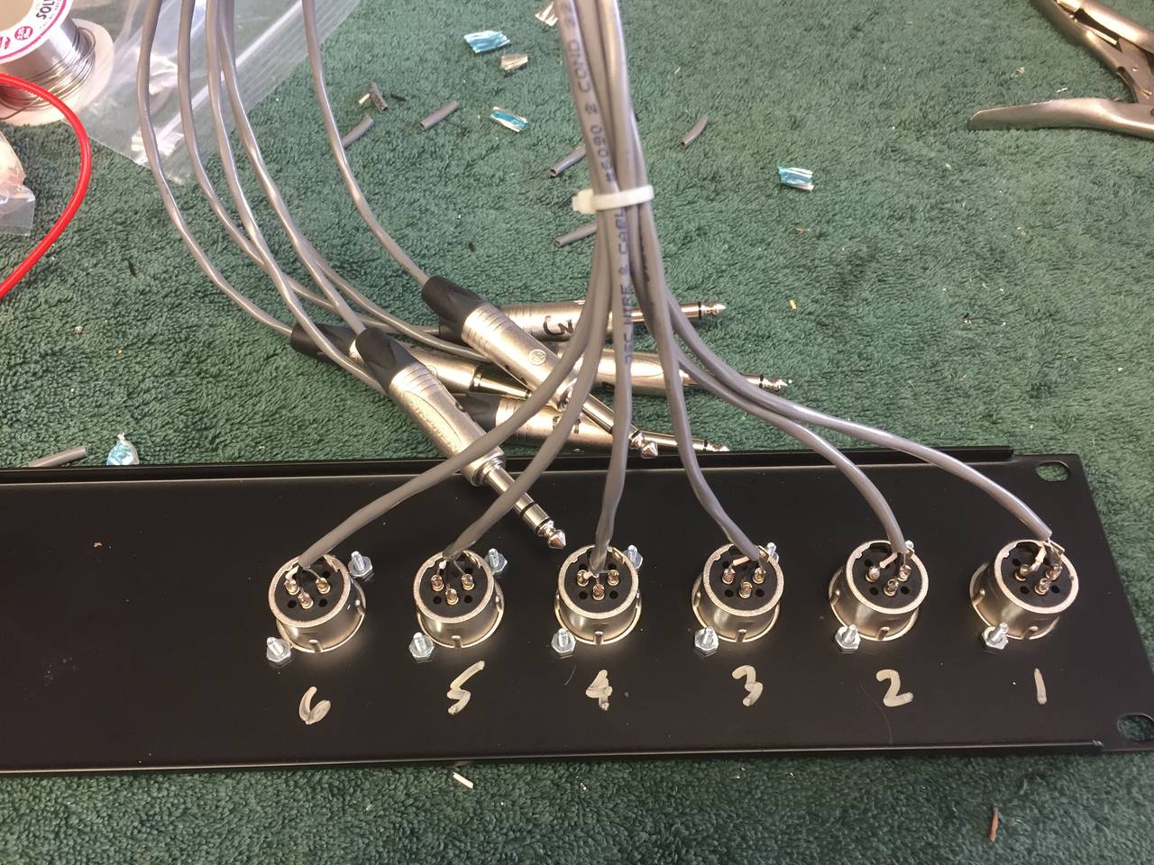

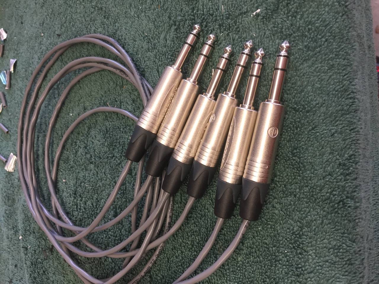

The monitor outputs on the Presounus are 1/4" TRS. I soldered up the ends first, then solder that to the Panel.
A quick note.....if you don't know which pin on and XLR goes to which part of a TRS connector, remember this:
Pin 1/Sleeve - is always the ground/shield/drain
Pin 2/Tip - T for two - T for tip
Pin 3/Ring - Three RING circus

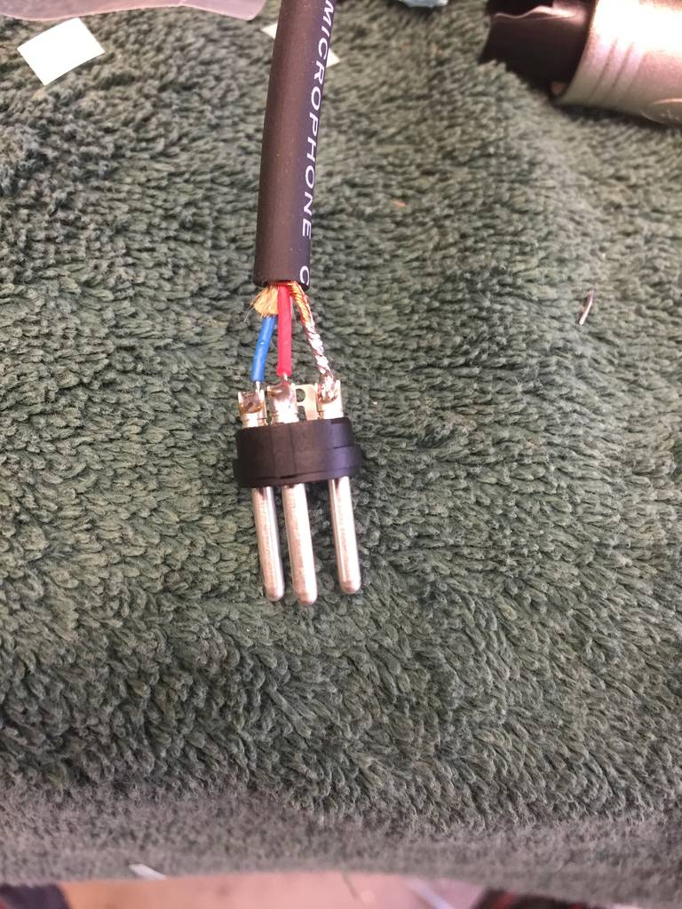

You'll notice that I'm using install wire. There is no reason to use rubber-jacketed mic cable inside a rack - it is harder to work with, takes up too much room, and is hard to bundle. The wires inside the install cable is the same as mic cable. I'm using 22ga - same a all of my mic cables.

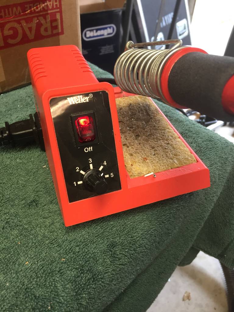

Now, if you don't have a good soldering station - get one. I messed around with stand-alone irons for years. And don't buy a cheap station - I tried. Bought a $30 one from a different manufacturer and it wouldn't get hot enough to solder up 12ga speaker cable. Took it back and got the Weller for $50. Never a problem - been using it for years now.
- Posts: 8678
This is what good solder joints should look like......

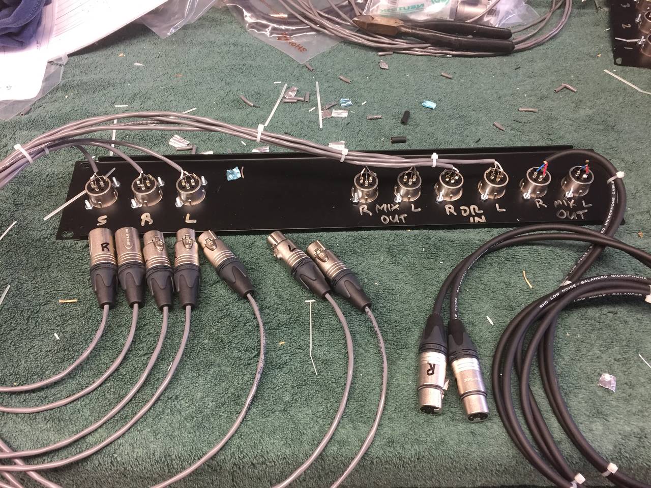

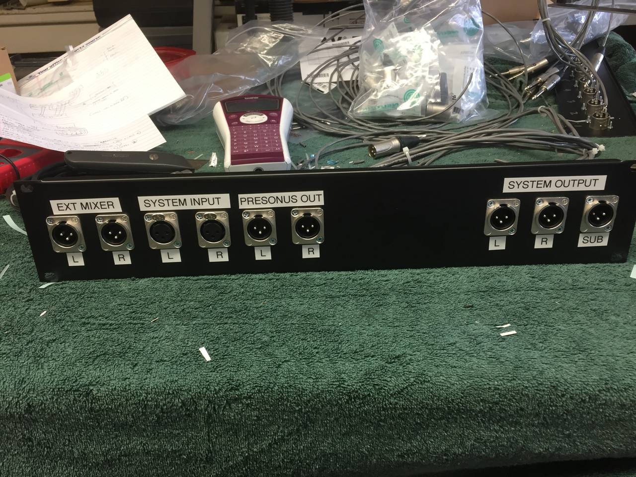

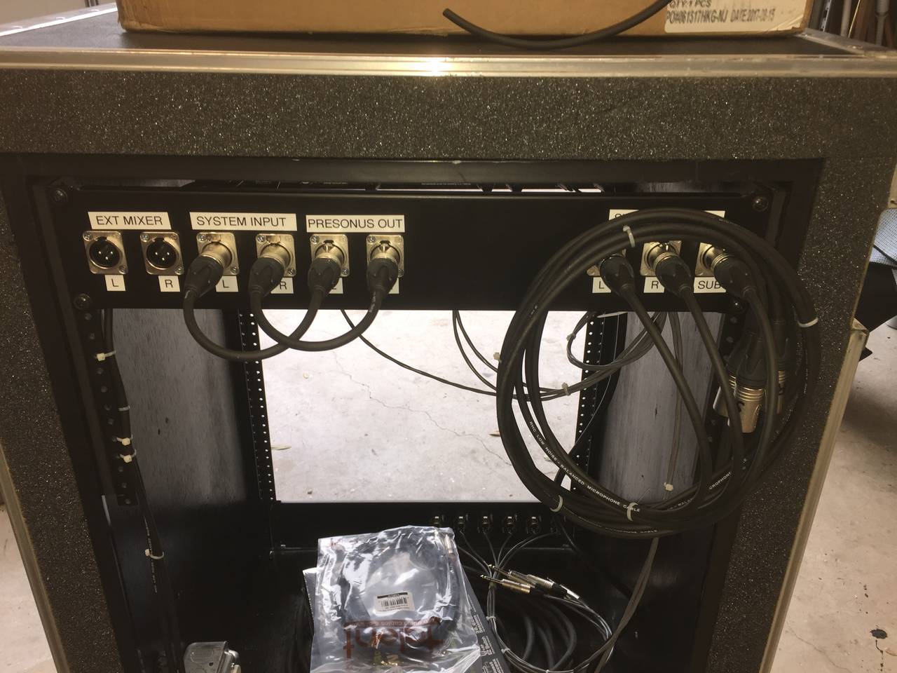

Here's the finished back panel.
You'll notice the rubber-jacket cables on the far right. That is for connecting to an external mixer should they not use the rack mixer.
Jumpers are used to determine whether the external mixer or the rack mixer is being used.
As soon as I get the mixer updated, it will be installed along with the rack drawers to finish this thing up.

Good info. I use a straight edge as you do, but only long enough to mark the holes with a fine tip sharpie felt pen, and then I remove the connectors and center punch and drill to the center of all the felt pen marks. I also prefer mounting the connectors from the back side of the panel as it has a cleaner look and offers a little more room for labels.
