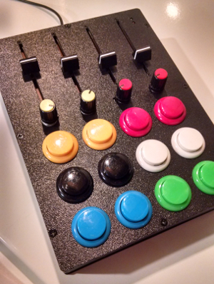

There is a ton of MIDI stuff out there, lots of examples to follow.
I built this one around the Teensy LC and it interfaces with Freestyler to control my lights.

Nicely done! Where did you get the knobs & buttons?

Re: DIY MIDI controller
Cool! Looks nicely build.
Why did you make it and what functions do you controll with it?
Thanks guys!
I built it for the sole purpose of controlling Freestyler DMX software, which can accept MIDI commands. You could also use a similar set up to control DJ software as well. Really this is just a Human Interface Device, so I can mash buttons or turn knobs instead of clicking on a mouse.
Freestyler can map MIDI buttons to specific tasks. For example some of the large push buttons start and stop my ADJ pocket scans, with pre programed sequences or shows. Each show as a set of commands that I sat down and set up beforehand. Like white light - move mirror left, move mirror right, change color to red - move mirror up, etc.
Right now I have the 12 buttons (cheap Chinese Ebay, for $12
) four Linier potentiometers, three rotary potentiometers and one rotary encoder. The linier faders control the flood lights and the rotary encoder changes the flood light colors. Oh, I got the potentiometers and encoder from Newark, but Digikey and Mouser also have them.
SWEET! I want a light setup so bad but I my stuff collects dust nowadays.
I love home-brew gadgets like this. Are the rotary pots linear? It's a big deal in the guitar world
Really cool. Having physical faders is so much better than using a mouse.
This might be a winter project for me.

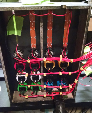

The intractable that I linked in the 1st post will show you the basics of building the controller and how to wire everything up.
There are several ways to accomplish this, but to keep things simple I used the onboard voltage regulator of the Teensy LC to provide voltage and ground for all the switches and potentiometers. ( in this case 3.3vdc out, limited to 100ma of current. Enough for this project ) The Teensy itself is powered though USB.
Note that this Teensy input pins are only 3.3v tolerant, if you were to apply 12v to one side of a pushbutton and wire it up to an input you would damage the Teensy.
In this example all the pushbutton switches are switched ground. I daisy chained a ground from switch to switch, then ran the other side of the switch to a pin on the Teensy. (There are many ways to wire switches to microcontrollers, but in this example, no filters or extra components are required) The Teensy's pins may be assigned to read an analog source or a digital source. The bush buttons are treated as digital sources. off or on.
Here are the ones I used, but ANY momentary pushbutton will work, just make sure it's off (on). It makes the connection when you push the button, some are backwards.

These will take 3.3vdc, ground, and then the wiper is what gets wired to an analog pin on the Teensy. These could be wired straight in, but you may see the value jump around a bit. A filter capacitor wired to that input pin to ground will help eliminate noise.

Here is the code, i know it looks crazy, but all you need to change is the buttons, faders etc. Everything in Blue is a comment and not part of the code.
For example
Analog fader2(18, Channel_Volume, 2); the number 18 is pin 18 on the Teensy
Digital button2(1, C4+1, 1, velocity) the number 1 after the parentheses is pin one. You may note that the C4+x just counts on, with how many i have hooked up.
This is an example of the "Analog" class of the MIDI_controller library.
Connect 4 faders or potentiometers to A0-A3. These will be MIDI channel volumes of channels 1-4.
Map these in your DAW or DJ software.
If you are using a Teensy, make sure you have the USB type set to MIDI.
If you are using an Arduino Uno or Mega, use the HIDUINO firmware for the ATmega16U2.
Written by tttapa, 21/08/2015
https://github.com/tttapa/MIDI_controller
