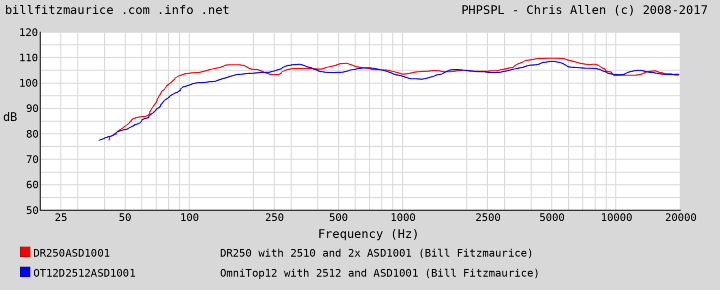

Sounds like you have a good plan. The 2 things I would suggest is build some DR250s instead of OTop 12s. A lot more time consuming, but well worth the extra work.
See that 6dB@80Hz gap? No matter where you cross over to the subs, the DR250 will do it better.

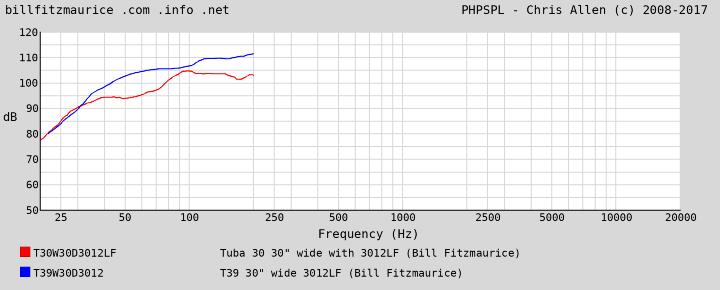

And T39 over T30 with the 3012LF. While the T30 is better below 38Hz, the T39 more than makes up for it in SPL above 38Hz.
NOTE: Both subs are 30" wide, 3012LF loaded for equal comparison.

As I mentioned in the Tuba/Titan forum I'm concerned about losing those lower frequencies as there's a lot of reggae down thereWhile the T30 is better below 38Hz, the T39 more than makes up for it in SPL above 38Hz.

You need to look at the SPL chart I posted again. The T39 beats the T30 all the way down to 32Hz. The difference is the T39 gives you the extra SPL where you need it. The extension over SPL argument has been hashed over so much, it's mind numbing. Build T39s.tactix wrote:As I mentioned in the Tuba/Titan forum I'm concerned about losing those lower frequencies as there's a lot of reggae down there
If you really, really, just gotta have that tiny bit of extension, build T48s, they really beat the T30, at the expense of a slightly larger box (48"x24"x24"). T30 at 30" wide is 15.625 cubic feet, T48 at 24" wide is 16 cubic feet.

I guess this is something that I don't understand. How if you are filtering out the content below 45Hz (on T39) or 35hz (T30) is the response on these curves meaningful?DJPhatman wrote:You need to look at the SPL chart I posted again. The T39 beats the T30 all the way down to 32Hz. The difference is the T39 gives you the extra SPL where you need it. The extension over SPL argument has been hashed over so much, it's mind numbing. Build T39s.tactix wrote:As I mentioned in the Tuba/Titan forum I'm concerned about losing those lower frequencies as there's a lot of reggae down there

They are only meaningful down to the lowest crossover point of the cab. If you want content down to 35hz, then T39s are NOT for you. If you are good with 45hz, then the T39 is the better option as they are louder.tactix wrote: How if you are filtering out the content below 45Hz (on T39) or 35hz (T30) is the response on these curves meaningful?
The T39 can go below it's suggested crossover point, but you'd have to really limit the power you put to it and totally rob the cab of it's intended use......right tool for the right job.
The real question is always - Do you really need to go below 45hz? I lot of people think so......I'm not so sure as only a small amount of content actually goes down there unless you are only playing specific genres. But, that's a decision you have to make.

That's what I thought - thank you for the clarification. I decided to build T30s on account of having done test with music sources, filtering below 45hz in Audacity, and being unsatisfied with the results. 35hz was better, 30hz more so on some tracks.Bruce Weldy wrote:They are only meaningful down to the lowest crossover point of the cab. If you want content down to 35hz, then T39s are NOT for you. If you are good with 45hz, then the T39 is the better option as they are louder.tactix wrote: How if you are filtering out the content below 45Hz (on T39) or 35hz (T30) is the response on these curves meaningful?
