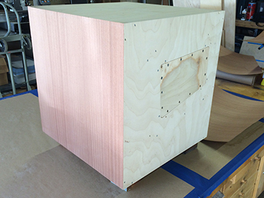

Built this T-18 a while ago and had intended to post the build, but didn't get around to it. Have moved since then and found these pics of the build and wanted to finally post them. There were more details but these were all I could find.

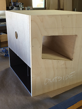

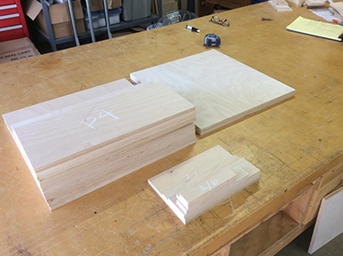

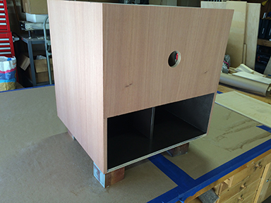

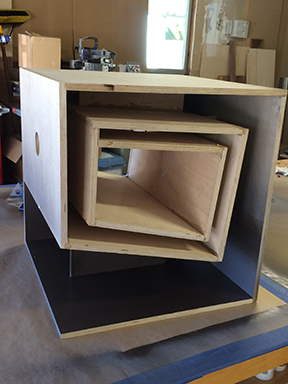

All Baltic Birch parts cut.

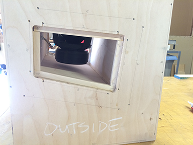

The hole access (eventually to be on the backside) is for the post cup. The visible inside parts are painted.
Everything (mostly) sealed up.

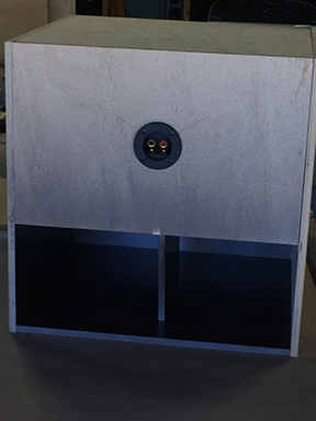

"Backside" view with post cup test installed.

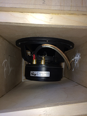

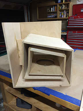

Driver installed and wired. I broke in the sub for at least 12 hours before it was installed.

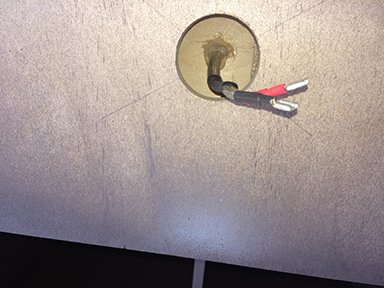

Wires routed and sealed from the driver chamber.

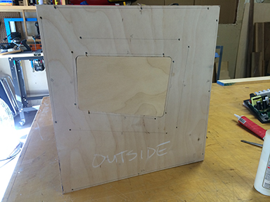

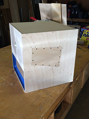

Dry fitting of the access panels.
Panels installed and leak tested.

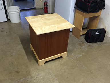

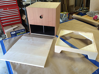

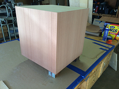

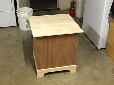

After all surfaces to be veneered were sanded flat and smooth, the Sapele veneer was cut a little oversize. The veneer has a heavy paper backing which is easier to apply. It's real important to test and make sure that the sub is properly leak tested and  working before the veneering process.
All four sides were veneered with contact cement and then carefully trimmed.
This section of veneer had a couple of small specks so I applied it to the "back" side.
The base and top were made out of solid figured maple.

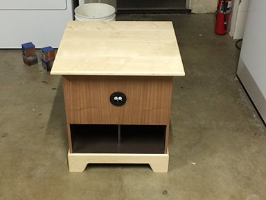

Front view after final assembly, sanding, and sealing coat.
Back view.
Back view.
Front view after 3 coats of polyurethane.
Back view.
Back view.

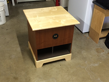

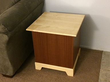

Finally finished.
Finally finished.

Nicely done!!! :clap:
CoronaOperator
Posts: 1648
Re: T-18 Build Quick Pics
#6 Post by CoronaOperator »
Looks great! How does it sound?
Bman
Posts: 78
Joined: Mon Apr 08, 2013 4:22 pm
Location: Murrieta, CA (SoCal)
#7 Post by Bman »
CoronaOperator wrote:Looks great! How does it sound?
In the house where I built it, it could rattle every window in the house (single story, 8’ ceilings, 1800 sf). And all from an 8” driver. Where I am now, much bigger place and 2-story, there are definitely nulls which means I need to build at LEAST one more. :D In a word, awesome!
