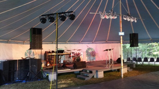

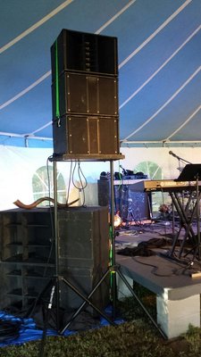

It IS a great combo for live music, isn't it?
6 OT12s, 4 with Deltas and horns, 2 with 3012s and melded array.
4 T48s 24" with 3015LF.
4 Wedgehorn 8s
ONE 15 amp breaker. (Barely)
107 dBC @ 75 feet for 3 hours. Smooth mix, no harsh complaints.
4 Wedgehorn 8s

The melded should be on the bottom of the stack for maximum HF dispersion at close range.

I know....
4 were good enough for the first 2 nights. Had to add the melded for the headliner.
Had great dispersion with the comp horns initially, and I think the melded did well with the tent being close.
