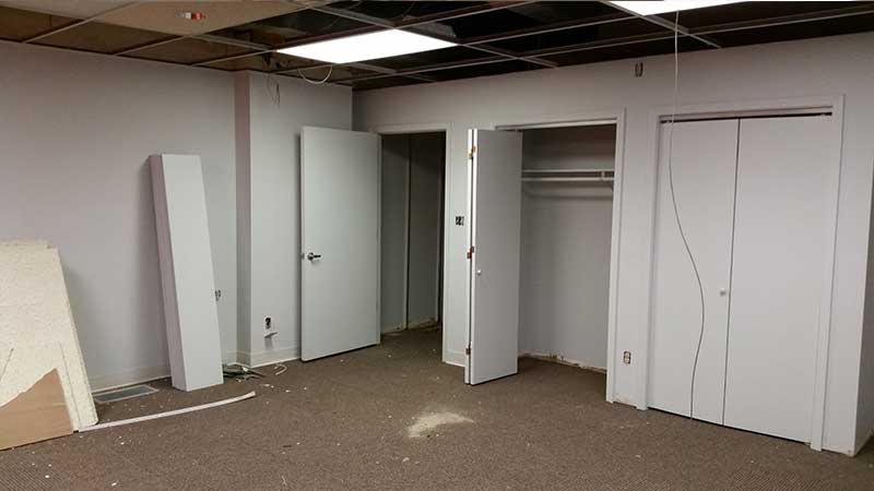

I agreed and soon they found a new building to move the entire company to. What I had to work with initially started out as a 21' wide by 19' deep typical office complete with a rather odd, standard full size closet, built outside a.. closet...? (Yeah, you read that right) They quickly threw me in this abomination and inexplicably turned out the lights. I stayed that way for nearly half a year.
I now submit, the beginning:

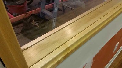

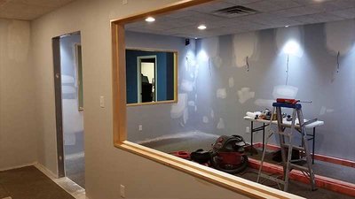

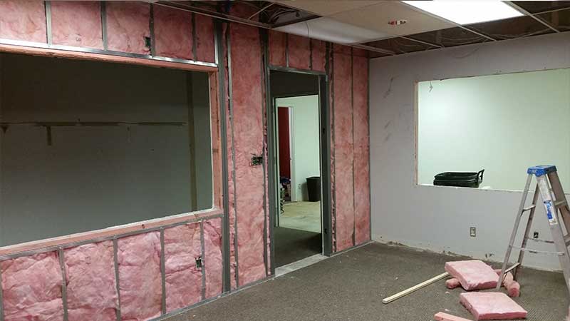

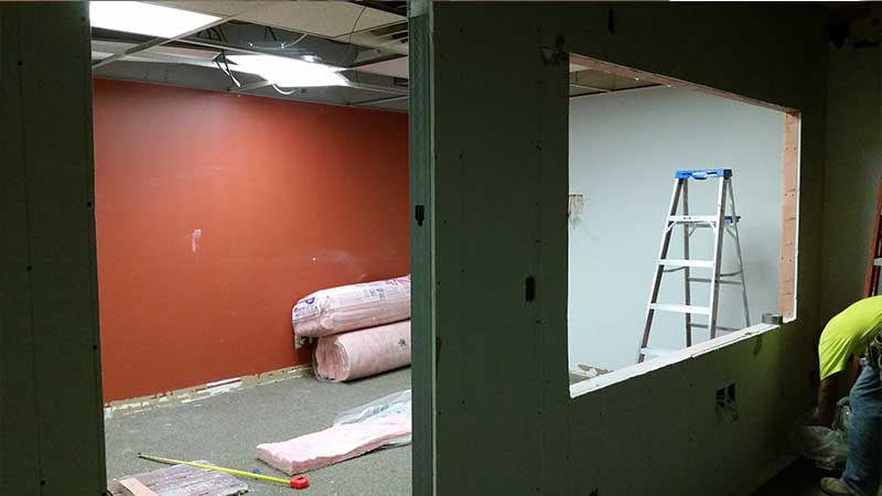

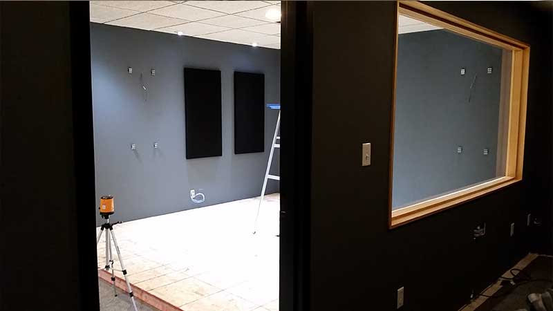

Then I started getting real. Oh yeah.... After the walls were sheetrocked, I immediately set to building custom frames for the ginormous observation and control windows (8'x4' behemoths!). Now, know that the frames had to match the doors that were on order. Had to! (or so I was told) So I did precisely that.
Pro-tip: Stain matching sucks!
But I got through it. Hard maple conditioned and coated twice with Some Honey Wheat followed by 3 coats of clear Polyshade, hand-rubbed between each coat.
Even with the now serious lack of skin on my paws, I was forward-looking and decided to route out the hidden side of the top of the window stop/spacer (of the observation window) and hid 20 giant packets of silica gel in that trough! Hey, the squirrels need something to munch on and any moisture between the panes would get 100% absorptionly goodness. (yes, absorptionly is now a word)
I then had the window glass created and installed by a local firm.
The observation window assembly consists of two panes of 1/4" sheet glass, the outer one being two 1/8" sheets laminated both separated by 2.5" of air space. This was to match the mass of the 4-1/2", 1/2" sheetrock, full foam filled wall that it sits so comfortably within. The Control Room window is a single pane of 1/4" laminated.
Explinachio: The reason for a single sheet is in the story of the doors. You can see an example lurking in one background of some of the photos below. Oh those doors... Well, since they HAD to match that doors already in the space, and since there was a single-pane, full light door in the control room to the studio, it didn't make sense to double-pane that window. The mass equalizer is the combo of that *plus* the main entry door.
Confused? Don't be, I have more pics!

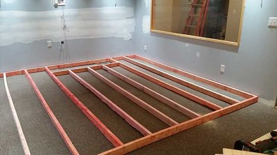

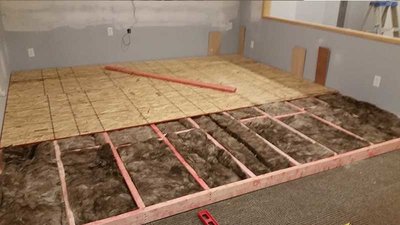

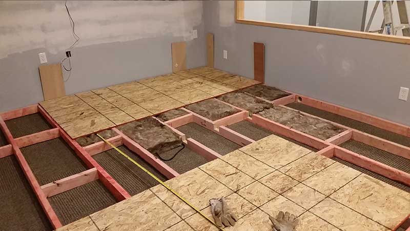

Now, with this all being a future studio, I thought- "Hey, you- glutton for punishment, why not have a stage?" (again, talking to myself in a random corner).
Inexplicably, I began building a platform of sorts. Don't know where that came from but, for cable management and the oh, so, important prestige and such I'm sure.
And then there was a stage!

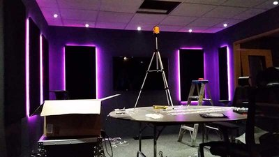

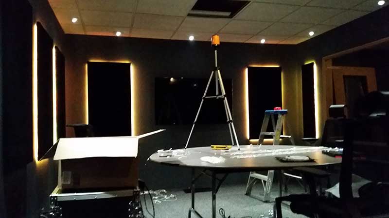

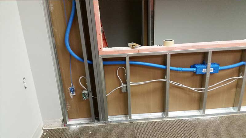

Ohhhh, only the keen eye will notice the big black wall artifacts, and that I left a bunch of random wires sticking out of the walls at pre-determined locations with no discernible connectors on them. What could he possibly up to here you ask? (not that you did, but I was certainly curious)
Ok, imma let you in on the secret.

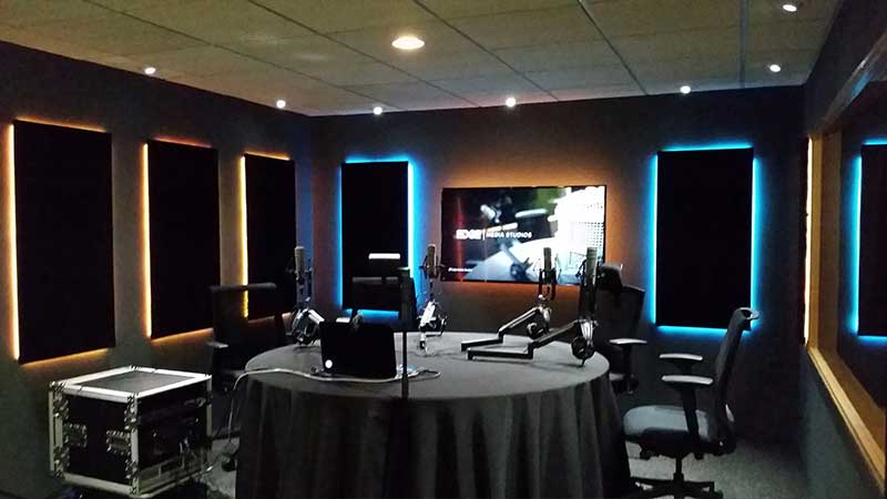

Another goal of mine here was to be able to have a different look for different clients. (Yes, the studio is available for client use!). And I thought one way to do that is with lighting. Lighting I tell you! I achieved this by running leads to each of those points around the circumference of the main studio space. I then attached 5050's to the back some awesome sound absorption panels, all 2'x4'x1", spaced evenly about the place. Hooked each of the 4-wire leads to a 36ch DMX control board that hangs out above the drop ceiling and ran the dmx control cable down the Control Room wall. It's got connection points in both the main studio and the control room for totalitarian flexibility!
Wallah! Two birds with one stone!! Sound control and nifty hip cool lighting!
The bonus is that the can lights we installed around the perimeter ended up working perfectly as backlighting for the videos we shoot in there. They are eyeballs, so are adjustable, and LED so, they are twice cool!
Now for some Sexy shots!

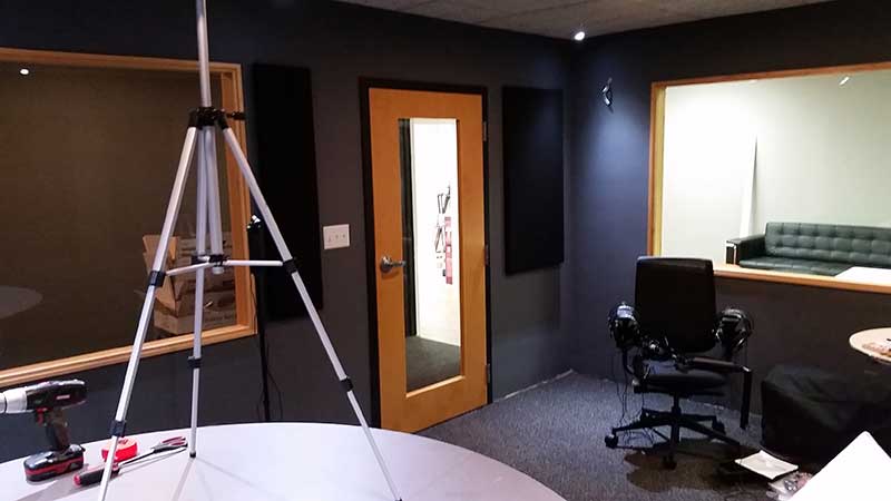

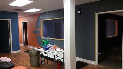

And- oh yeah, ceiling tiles, first door and a keen power-button inspired murial!

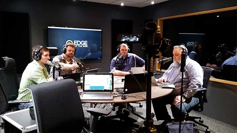

Ok, now for the other good stuff.
Shortly after the above pic, we were able to shoot our first "podcast". Rough set up I know, but whadyagonnado? I had to throw sumthin' together in a hurry since we said goodbye to the horse blankey rooms a bit too early
And yes, my station (as engineer/director) was in front of that rack flight case that held the mixer/amps. - Of course I had no choice at the time, the control room was an empty shell of a control room, that, and I enjoyed being able to wag my fingers at the talent as often as my heart desired. Even if it sometimes it was just for yucks
Every time they asked me when the control room would be ready (and that was often for some reason) I would just wag my finger and them and run away cackling. Later, their permanent smiles told me that they too were happy that I was able to use said room.

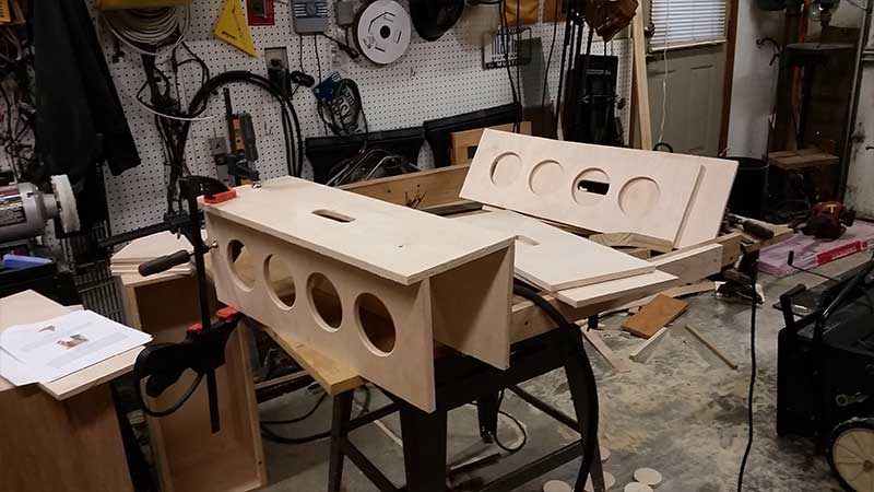

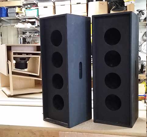

Now.. me being me..(drooling notwithstanding) early on, I knew I could not rest with "just a studio". As is typical, I mulled things over and thought "Hey, dorkensnorf- You've built mobile audio systems before.. why should this be any different? What if we want to record at the county fair or the next astrology convention?". So, agreeing with myself I decided to make us mobile! Yes, that would explain the flight case in the previous post. And having made that decision, it became immediately clear that I needed some things that would create sound in the event that we want to entertain our loyal fans! (and by "fans" I mean passerby's that don't do that wrinkly face thing upon hearing our yammering)
So, what better opportunity to do just that (given that my hammer and saw were both now cooled off) - create some pro sound for the space and make them useful on sticks as well!
(Cue ominous music) Enter, the SLA Pro:
