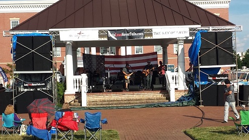

I was at a show with their slightly smaller cousins on 1 July. These boxes had dual 15, dual 10s and dual 2" comps per box. 8 tops and 8 dual 18 subs.
Old school horsepower........

David Raehn wrote:I was at a show with their slightly smaller cousins on 1 July. These boxes had dual 15, dual 10s and dual 2" comps per box. 8 tops and 8 dual 18 subs.
Man, I bet that was smokin'!
