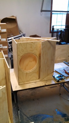

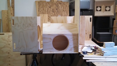

Not sure if I read the plans properly, I thought I was going to build birdhouses...maybe they're birdhouses for turkeys?
- Attachments
- Birdhouses.jpg (38.51 KiB) Viewed 2190 times
- Birdhouse.jpg (31.52 KiB) Viewed 2190 times

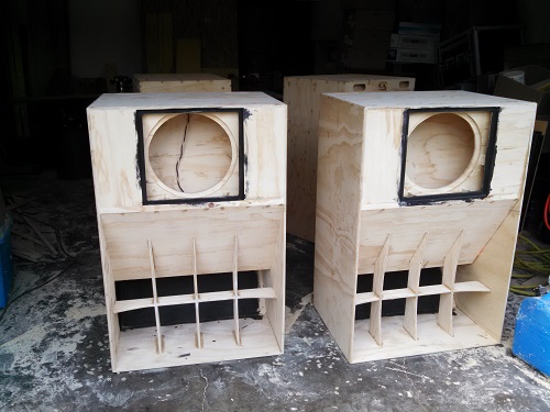

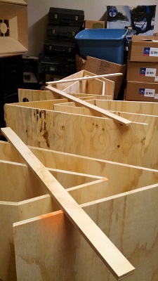

Surprising how fast they're going together... Seems like it's taking less time than it did to build my two T48 Slims. These are four T48's, 32" wide, with 3015LF's.
- Attachments
- Maze.jpg (41.24 KiB) Viewed 2187 times
- Side.jpg (38.17 KiB) Viewed 2187 times

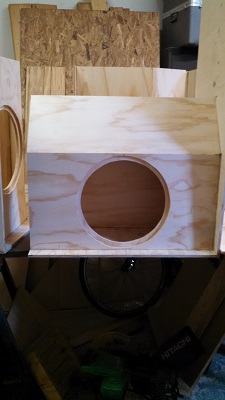

It's interesting the comment about birdhouses. When a friend of mine saw the T48s half built, he arrived at the same impression.

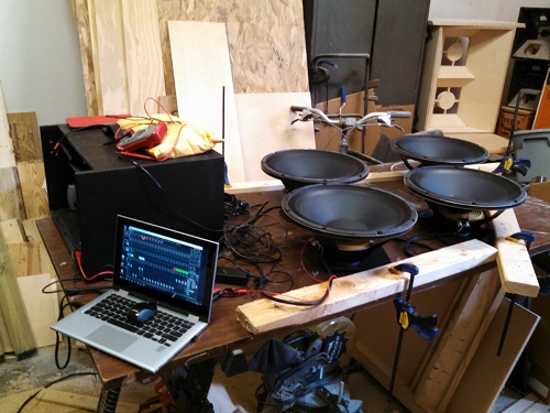

-4 3015LF's breaking in on the table still make a fair bit of noise. The 3012HO's I put I my Jacks were like a whisper in comparison. My Dad thought I left my air compressor on.
Hopefully I get to hear them bark in the next couple of days.
