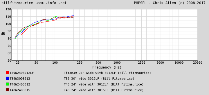

I was considering building 4 x T48 single 15 cabs to replace my 4 T-39s but I don't have the plans yet.
Anyone know how many 5x5 sheets it takes to build 4 T-48s that are 24 inches wide?

Best use of the wood would be to go 30 inches wide if you have the pack space. Since the ply is 60 inches wide, you will have very little waste making 29 inch panels.

Do you need more volume? Or do you want more extension? If you want to gain volume, build more T39, as wide as you can. 4 T48 pack space = 27,648 inches cubed. T39 pack space (24") = 18,252 inches cubed, T39 pack space (30") = 22815 inches cubed. You don't gain much SPL to justify the size difference. 4 30" wide T39s give you pretty much everything 4 T48 give you, except 5Hz of extension, in quite a bit less pack space (19,332 inches cubed).
