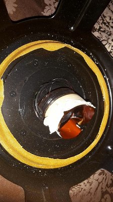

Back at home i find the Beta-12 was stuck and all the way back. No way to move it. Completely burned. Once again: weird, I limited at -8dB, so that should be no more than 270W peak, and the other was still perfect...

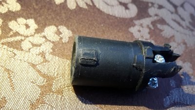

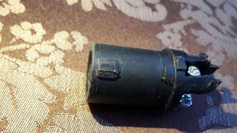

After further inspection I found the following: They managed to push in the Speakon cable up-side down, connecting full power of low frequency's, intended for the subwoofer, to the poor driver.

The only possible defence I can find for them is that the speakons are cheap china ones I bought when I was on a low budget. No idea if regular speakons are harder...
