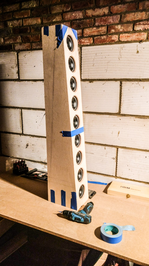

Since I'm more into listening music then having a full blast of sound kicking me out of my couch while watching a movie, I went for a stereo setup of the SLA.
After reading through the plans and some questions asked on the forum I decided to make two cabinets with each 9 full-range 4"inch drivers from McGee
I'm living in Europe and couldn't find the recommended cheap 4" drivers without paying a big shipment fee.
After a long and thorough search and a couple of questions here on the forum I settled on some full range drivers of McGee, so no tweeters where necessary.
I also made a different choice about the design of the cabinet. I like to see the wood and use the multiplex layers as a style element. I also made it myself a bit more difficult by tilting the front panel by 4°.
Next my build process:
The corners of the cabinet are all cut at 45°, this way the layers of the multiplex will make nice corner. The frontpanel is recessed into the side panels.
I test fitted the drivers. No glue yet, only hold by the blue tape :D
