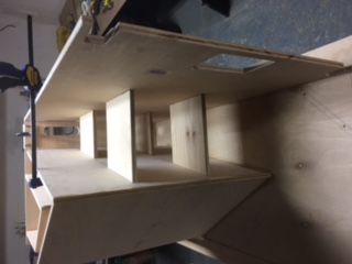

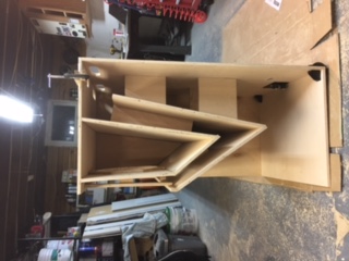

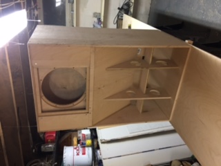

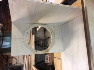

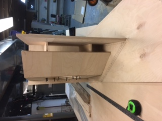

Hey all, another T39, build coming along nicely

Is that a 24" wide version?

Will do and thanks again Bruce for your wisdom... Chris, it is the 24" version 3012lf loaded.
This build went well with only minor adjustments (trace lines!) albeit remedied. The second build should go even quicker now that I have made notes on the build sheets! OTOP's will be next with proxied advice on quantity. I'm going to build 4. I'll need to update the plans tho, it's been quite some time ago when I purchased them initially.
