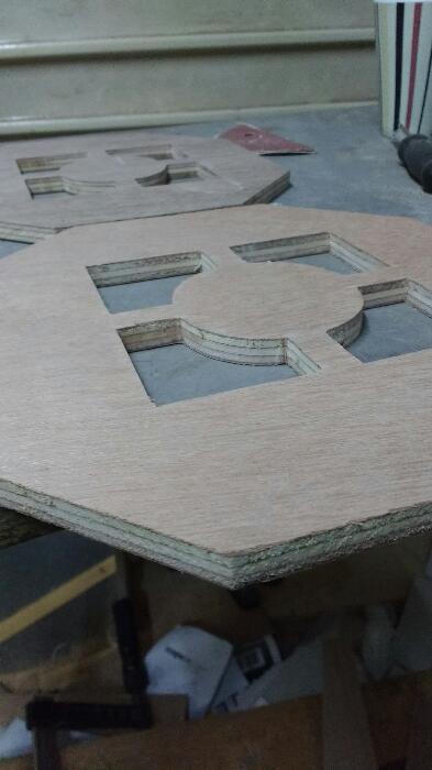

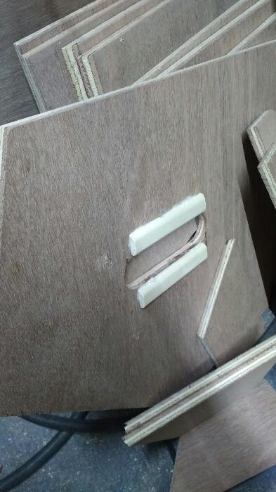

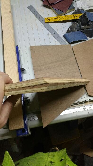

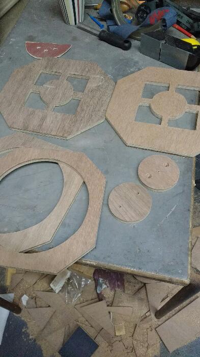

Here's some pictures of the piece parts.
3 of the trickiest things so far:
Trying to jig saw 2 thicknesses of this plywood is a no no - the blade bends off due to the hardness of the wood. I managed to fettle the baffle that was on the underside of the one that was marked out, but it was very wonky to start with.
Also, routering 2-off phase plug discs or driver spacers in one go is also tricky, unless all the pieces in the stack are screwed through.
Finally, cutting the mitres on the edges of the horn mouth pieces is tricky, on a table saw, mainly for the non parallel edges. I used the angle gauge T-slide to do it.
I have very much enjoyed cutting out the pieces though - nothing as satisfying as marking a piece of wood out and ending up with something close enough to the marks as to be useable. Of course, we will see about that, yet, LOL, but it's only practice and some technique, for those who are hesitant.

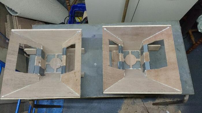

#4 Post by Charles Jenkinson »

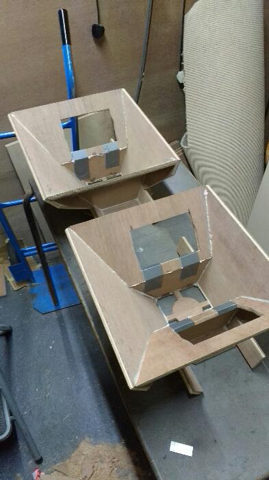

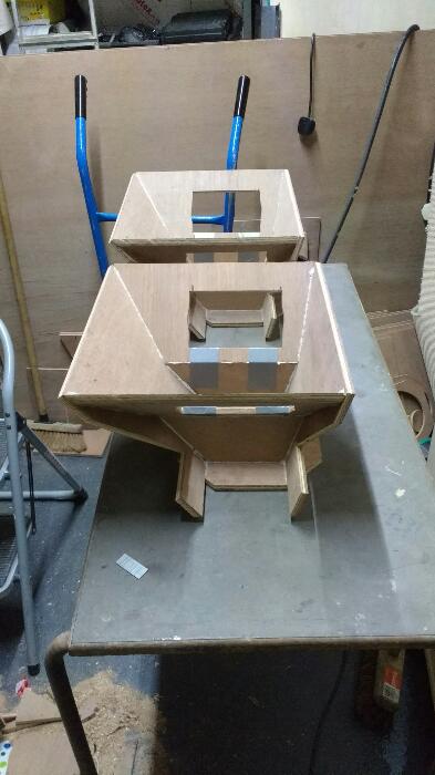

Got the horns assembled this evening. The first one was a little out of square. I realised that guide marks are required to set the height position up the baffle of the first two horn side pieces fixed - if they are not exactly the right height it throws out the bottom horn mouth piece, when it is abutted into place. I measured down from the baffle upper most outside edge for the second horn, put some marks at both ends of each piece, and that horn is bang on square. These height-wise positioning marks are actually essential if using a square block to help set the pieces, as per the plans.
The duct tape holds the mitres quite well on the last two pieces fitted.

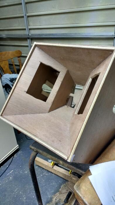

#11 Post by Charles Jenkinson »

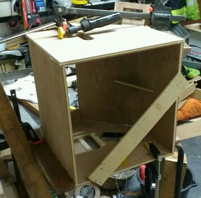

One shell in the partial assembled.
I found the trickiest joint was the bottom to lower back mitre. It required the un-glued top-side on with all edges lined up correctly and checked for square before the bottom panel can be set right.

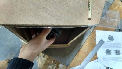

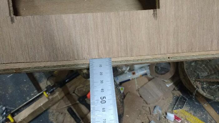

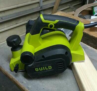

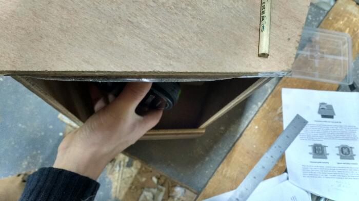

A little bit of progress today.
New tool required for the job of fitting the horn to the shell - an electric planer - I found the oblique cut through the plywood too challenging to trim with a small hand plane.
I'd quite like to leave the horn back 5mm in the shell so that the front mesh support frame can be a slightly different shape and be Velcro-attached. There's enough room to get the driver in as long as it won't affect tuning.

Re: Wedgehorn 8's
#13 Post by Chris_Allen »
I've used electric planers on the end panels of cabs when they are quite square but they are very unforgiving if you kick out at right angles to the grain.
These cabs are looking great. How are you going to finish them?
Posts: 29087
Re: Wedgehorn 8's
Chris_Allen wrote:I've used electric planers on the end panels of cabs when they are quite square but they are very unforgiving if you kick out at right angles to the grain.
That's not the tool to use. A router atop a sled is. Even a circular saw atop a sled.

Bill Fitzmaurice wrote:That's not the tool to use. A router atop a sled is. Even a circular saw atop a sled.
I didn't have a router at the time and I couldn't cut square either! Fortunately, I don't have those problems now :D
