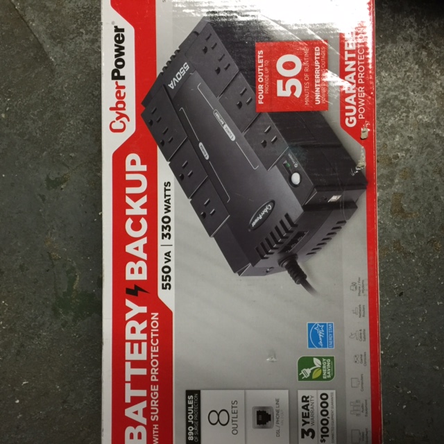

I bought one of these,my idea is to connect my Behringer DCX2496 to it just in case i run into a power outtage or someone im doing a rental for lets their generator run out of gas my limiter will still be functioning and possibly keep that spike or that pop from reaching my amp.Thoughts ?

You always want to turn you amps off before the processor/source signal to avoid pops. That UPS on the driverack will make sure the amps go off first even if someone pulls the plug or you pop a breaker. Its a good idea.
- Posts: 8664
Re: Battery Backup
You'd need it on the driverack and the mixer. While the driverack will definitely pop, the board can too.CoronaOperator wrote:You always want to turn you amps off before the processor/source signal to avoid pops. That UPS on the driverack will make sure the amps go off first even if someone pulls the plug or you pop a breaker. Its a good idea.

Cool,thanks fella's.
