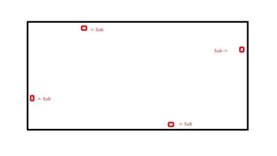

Vinnyw wrote:Does it matter with Direct Radiating subs if the cones are directed toward or away from the corner
Face the drivers into the corner or wall. I think, in a room that huge, placing 1 sub on each wall of the room to help even out the sound would be a better approach. Are you trying for concert level sound? I know of christian rock sanctuaries that rock out 120dB+.
