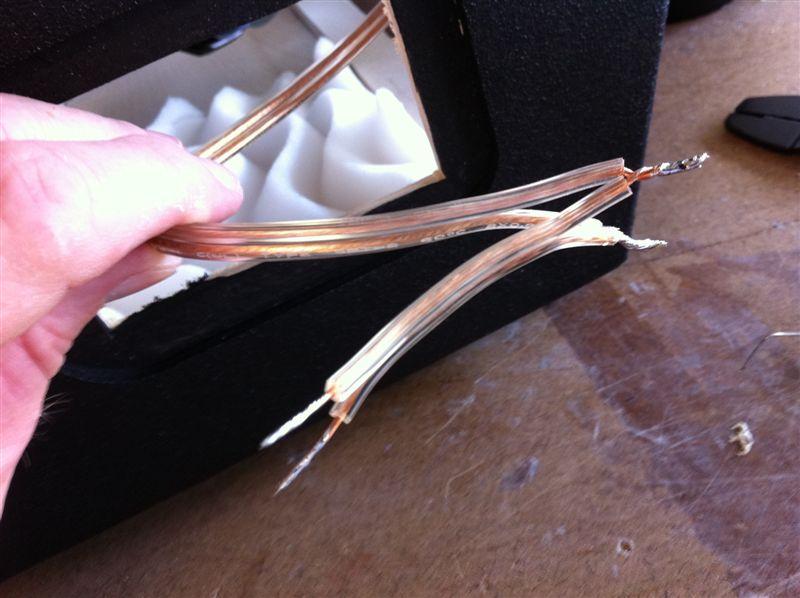

Or, you can build a jumper like this.....once the two wires are together, it's easy to attach them to the connector if you've tinned it properly.
