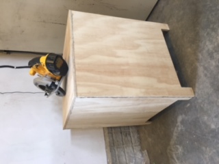

Pictures I took along the way. (not sure why my computer rotated them all funny?)
Skipped a few photo opportunities.... box assembled.

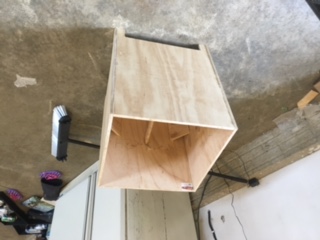

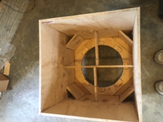

The 'not so pretty' inside shot.
Ready for the fabric inside to hold the stuffing back.

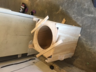

Mounting baffle.
Mounting baffle.

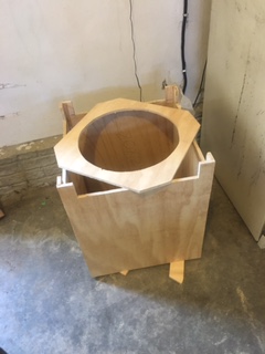

Sides and half the baffle done, working on the 2nd part.
