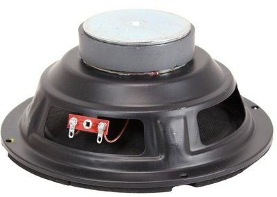

I can't seem to find any pictures on the back to see if they have a tiny magnet or not. No thiele small parameters either but I'm guessing they are going to have a weaker motor than the recommended Eminence/Faital Pro drivers

I couldn't find the model number of the one listed but at 10oz the magnet is small which is validated in the pictures here:
http://www.electromarket.co.uk/skytec-s ... ge-search1
The closest match for the SLA Pro appears to be the 902.195 but the Fs is still way too low.

I did manage to find some more pictures of the magnet on these things. For an ordinary ferrite magnet, it is pretty teeny tiny.
http://www.amazon.co.uk/Skytec-Speaker- ... ms?ie=UTF8
Even the Alphalite 6A magnet is bigger and it's a Neo!

After a quick google I found this:
http://files.tronios.com/Manuals/902.23 ... eSmall.pdf
So the BL is 4, Re is 8 and Qes, Fs is 110Hz, Mmd is 14g and Qes is 5!
Seems these things are way under-magneted.
I don't know what the xmax on them is.
