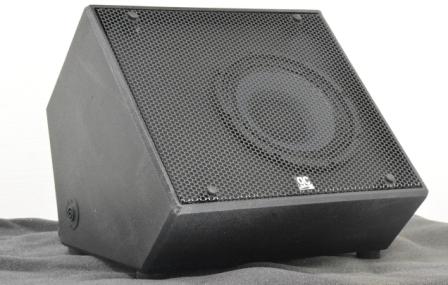

Nicely done Bill. Easy to construct, nice extension from the beta10cx, and your xover does a fine job of taming the Eminence peaks. This is a very good monitor.

Looks good. I think I'm going to build 4 of these.

I know we've done grills to death elsewhere, but that looks mighty tidy. Are those grill fasteners and stand-offs a Penn Elcom part? I'm thinking they might work better for wedgehorns than the previously referred blind clamping strip methods (that I think Jools from London used), particularly with the inner horn taper getting in the way. Though some sort of return / fold on the mesh edge is needed for rigidity, but it's got be slightly over 90 degrees for a WH.

7/8" return bend on the grille. 1" rubber feet underneath. Screws and caps.
