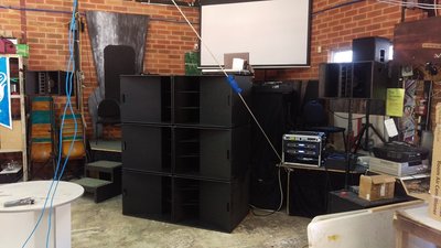

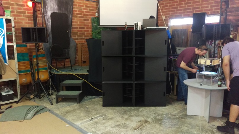

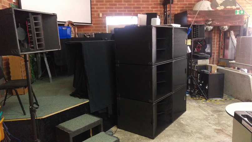

So we did the sound for the Perth Artifactory's opening drum and bass night with the above deployment. I didn't think I would need to bother wall or corner loading, or v-plating the stack for that matter, with 6 subs against 2 tops. I made sure the mouths were more than 8 feet from any wall (they measured 8'6" from both walls, centered in front of the stage as shown in the pics). All up sounded great, there was plenty of sound for the entire 6 hour evening.
A couple of notes, we did experience room modes, interestingly a dip at 43hz (and another at 86hz) toward the centre of the room (to be expected indoors, but we were pondering how that would change next time if we moved the sub stack further away from the walls).
Also, for the last couple of hours we found the limits of the T30's (and turned down accordingly, not wanting to stress the system), so next time was thinking of v-plating the stack and moving it further out, maybe a foot or so. At the end when we were packing up, I noticed that the access cover panels on the sides of all subs were warm to the touch, and it rang alarm bells as I remembered sine143's post on his similar experiences with his T48's, here: http://billfitzmaurice.info/forum/viewt ... t&start=15
I don't particularly wish for thermal failures and am considering our options. A question, is there a way of integrating a liquid cooling system to assist cooling the drivers? Has it been done?
All up, a successful night, and great sound! A very versatile system with effortless SPL. Thanks Bill!

If your running close to max voltage you need more cabs or deploy them more efficiently.commander_dan wrote:
Once you near max voltage a lot of the power is transferred to heat anyway decreasing efficiency and distortion increases too, so it becomes a lost cause to try to cool an overworked driver just so you can shove more power into it.

Wall (+6db), or corner load(+12db), if possible, plus a v-plate (+3db).
That is quite the stack, especially when compared to just two tops.

Interesting. We ran 2 T30's off the XTi2002 and 4 T30's off the XTi4002, so those 4 were receiving more heat in that respect. I was never going to run all 6 off one amp though, for the sake of the amp (having heard from many that XTi's don't play well with 2 ohm loads), but I never considered that extra amps also = extra heat in the drivers. Good to know.
Roger that re more efficiently deploying the stack. That was our general thought at the end of the night too, although I initially believed the T30's would outrun the Otops, which is why I lazily deployed them. Next time we'll v-plate the stack at the very least.
