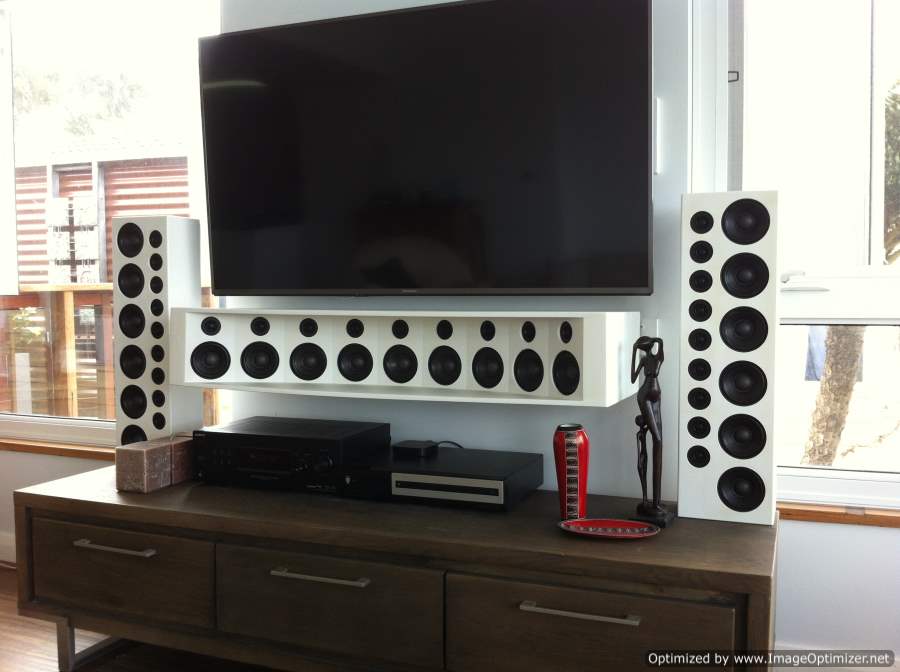

Beautiful work and a beautiful helper!
I hope the WAF works for me too, I'm hoping to do an SLA curved center with 9.
