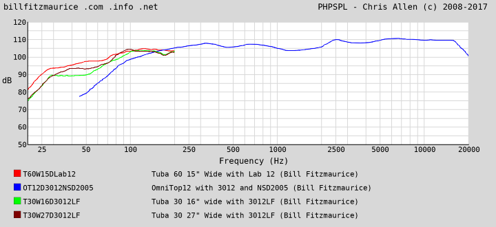

A BIG +1. As you can see by the charts below, You could cross over from the T60 to a DR280 @80hz. It will take twice as many OT12s to cross over @100Hz. Adding another set of cabinets would be a foolish waste, IMHO. Build DR280s and re-use most of the components from the OT12s into the DR280s. Worst case scenario is you tri -amp, which can be easily done with any DSP that has 3 outputs. Adding T30s will not get you there, unless you build with the 3012LF and to the widest width,27" (which is unlikely, since you are in the UK). Build a pair or 2 of the DR280, and 2-4 T60s. I hope you have access to a lorry to transport your system!Tom Smit wrote:Have you considered the DR280?
