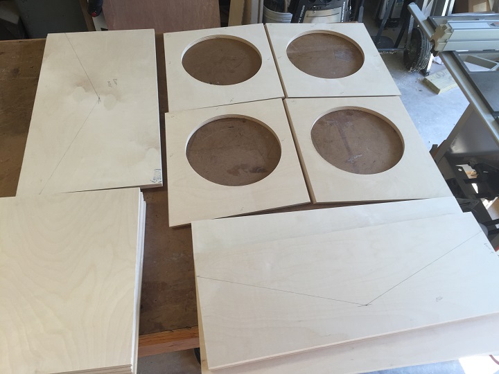

This won't be a really detailed build thread as these are pretty simple once you get the baffles cut. Those are more of a challenge, but if you know how to build a simple jig for the table saw - it goes pretty quick.
Gotta' start with the parts....

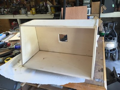

Glued up the case this morning......

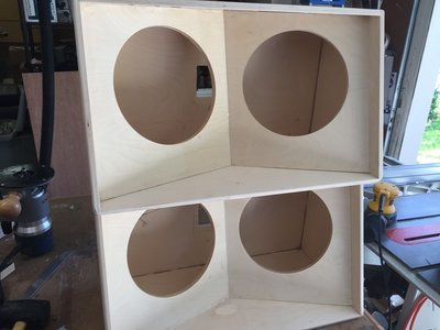

Routing and sanding are done......just need to add the grill blocks and start painting.

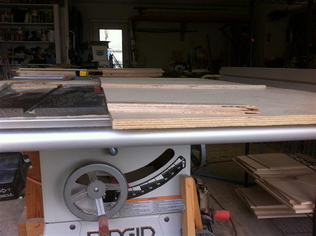

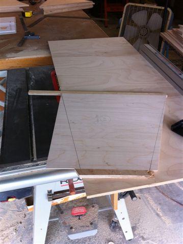

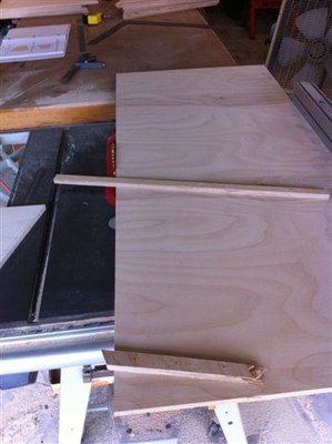

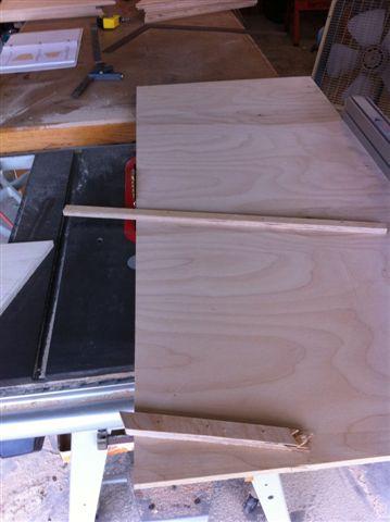

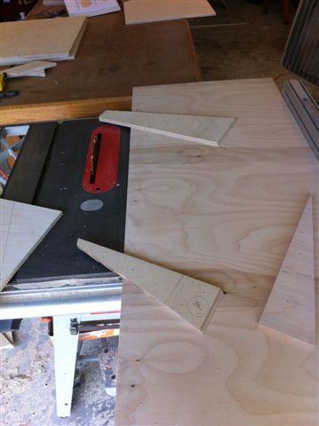

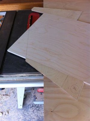

If you have a table saw, build a simple jig. I built one to build the WH10s a few years back and did another one for the compound cuts.
Here's some of the old pics from that build with two different setups.
Start with a piece of play wide enough for the baffles to be turned all directions. Put a strip of ply on the leading end at the angle of the first cut. To do this, lay your marked board down on the sled lining up the marks on your board with the edge of the sled. Take the strip and extend it out a couple of inches past the sled. Put it up against the board to be cut and to get the angle of the cut - then tack it down with a brad nailer or screws.
Now, do the same thing on the back end.
Adjust the fence so that the extension are going to get cut, but not the sled....an inch or two. Lock the fence and run the sled through with the saw blade at the correct bevel without the workpiece. You are only cutting the extensions. This is now your alignment edges. Put the workpiece on the sled. It should be nice and snug since you used it to place the extensions. Line up your cut marks with the edge of the extensions. Same thing with a different cut. The extensions had to stick out further in order for the workpiece to fit. Hope all this makes sense.
It works really well and I had all four baffles for the two XF10s cut perfectly in probably 20-30 minutes. That's 8 compound miter cuts.....and the time to build the jig (it's really just scraps).
