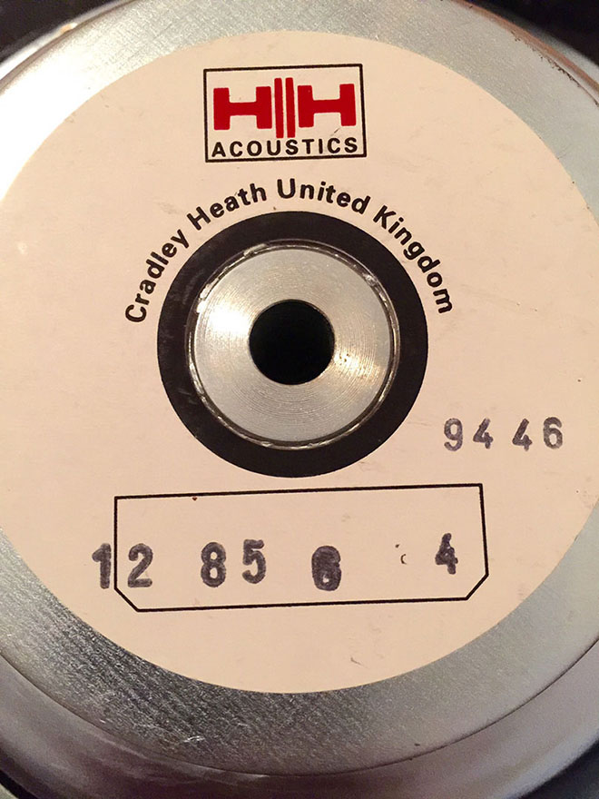

Can you post a picture of the old driver, or does it have any specs or numbers on it? Look especially hard all over the magnet.
Otherwise, post the internal dimensions of just the cabinet, and the size, shape and depth of any ports or ducts. You can't just drop in any old driver, and expect to get desirable results...

#7 Post by BSAphex »
DJPhatman wrote:Can you post a picture of the old driver, or does it have any specs or numbers on it? Look especially hard all over the magnet.
A pic of the old driver is below.
Internal dimensions for the cab are:
16"w x 12.5"t x 9"d
