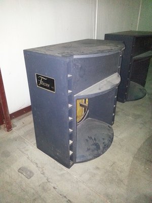

I'm acquiring some empty Frazier X-15 boxes. I liked the look of them and the price wasn't bad so I went for it. I'm in the beginning stages of gathering info on them. Does anyone know anything about these speakers? I'm hearing that original components are impossible to find so I will need to put updated stuff in there. Any help is appreciated. I hear that they can sound pretty amazing when redone correctly.

I remember using some Fraziers in a club in Milwaukee around 1974, they resembled EV Sentry IVs. They were rare then, and I doubt you'll find much information about them now. The X15 resembles the JBL 4560, but wouldn't work as well, the throat is too large to effectively load the driver, and being pre-T/S era the reflex tuning was probably a seat of the pants affair. It would take some good engineering chops to reverse-engineer them to find appropriate driver specs for them.

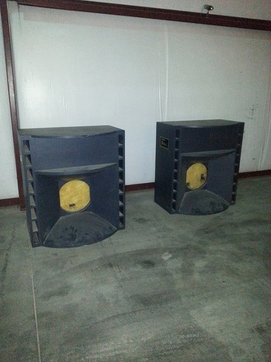

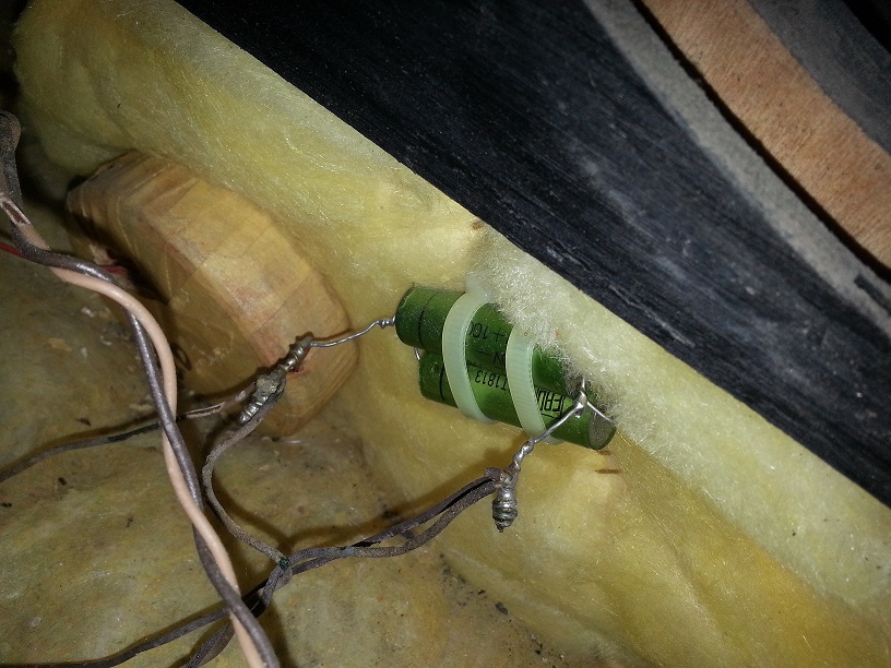

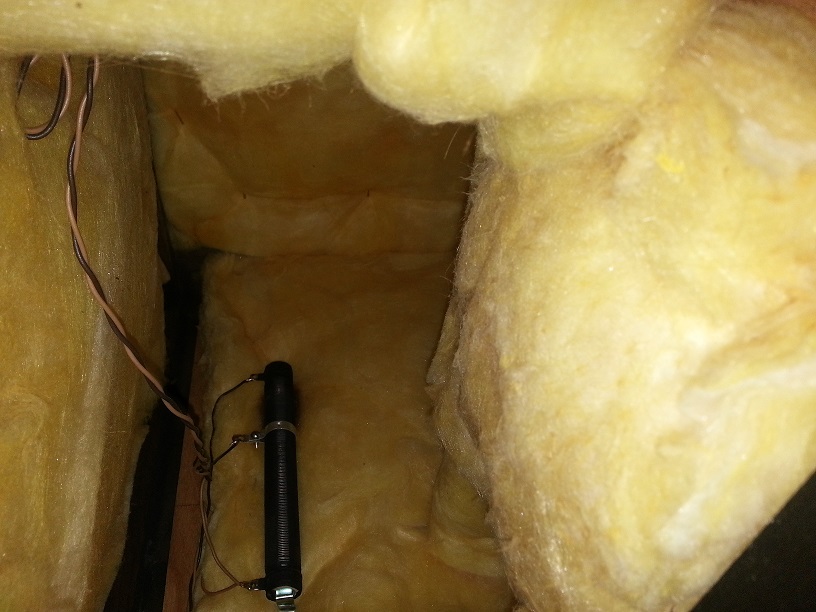

I got them! Looks like the woofer and horn were removed but the crossover components were left inside the boxes. Does that aid in figuring out what woofer/horn would work or not? Also, the "vents" along the sides do connect to the chamber behind the woofer. They weigh a ton!

Those may be X-15W's. The no-tweeter model. Might be a good candidate for the buyout Lab 15-4.....

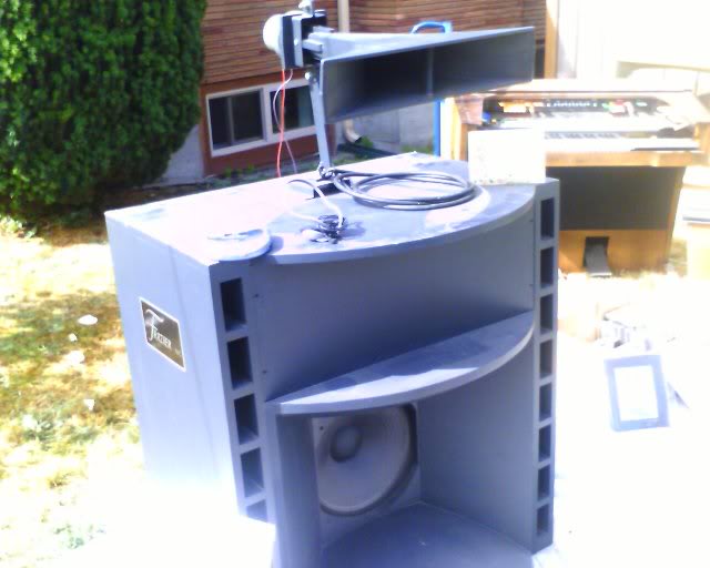

I see them with the horn mounted in the flat panel above the woofer and with a horn mounted on top of the box. There are 4 screw holes in the top of the box so something was mounted there at one time.
I'm curious how much work it would be to put a horn in that blank panel. I like that look better than mounting one on top. So far finding info on these has been difficult, fun but difficult.

Old Peavey SP-3 horns would be right at home there.
