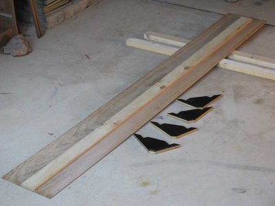

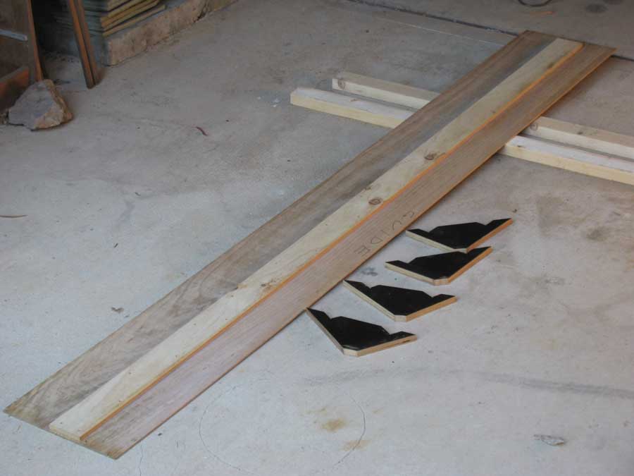

However I have made a 2400mm long saw guide and four "W" clamps.
The saw guide is absolutely brilliant. First time I've been able to cut straight cuts in my life!!!!! :clap:
Anyone contemplating a build with just a circular saw, MUST make one of these.
There are plenty of examples of how to make and use one in You Tube.
Saw guide and W clamps completed.

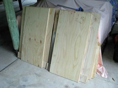

I've done a bit more cutting.
I have finished all the "rough" cutting of the front, back and internal panels.
I have also cut the sides.
A couple of tricks I've picked up already which might help first timers, like myself. :)
1. If using a circular saw, you MUST use a saw guide (or something similar).
I've previous built projects without a saw guide, and honestly, you are wasting your time without a saw guide. Simple to build and use.
2. When measuring and marking, use a fine tipped pen. I'm using a pen called a "Sharpie Pen". The very fine tip makes it easy to mark the timber on the exact spot against the tape/ruler. And then the pen also leaves a very fine line when drawing your cut line. I am also using a large square when marking a line to cut across a sheet (after I have ripped one side which becomes my reference straight edge).
3. When drawing a line against a straight edge, hold the pen at the same angle for the full length. This ensures that your line is truly following the straight edge.
4. When marking the width of a panel before cutting, mark in at least three spots (each end and in the middle). When lining up your saw guide with the marks, you can easily tell if one of the measurements is incorrect. I've mentioned this tip because it saved me from making an incorrect cut on one of the sides. Also, remember which side of the saw guide is the panel you're making. The saw guide should be sitting/clamped to the panel with the saw guide covering half the width of your marked line or spots.
5. And the tips that have been mentioned many times :- take your time, measure at least twice, and when you have the saw in your hand, hesitate and re-think everything before actually cutting.
With careful planning of your cutting layout on the precious sheets that you've bought, you can end up with minimum waste.
My cut pieces so far. Note that I've called the two cabinets A and B.
