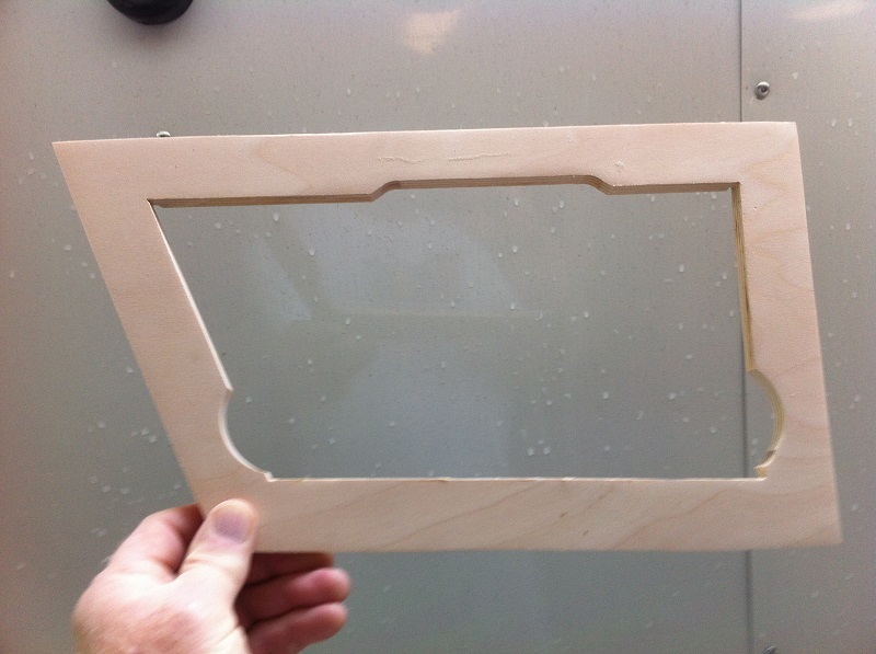

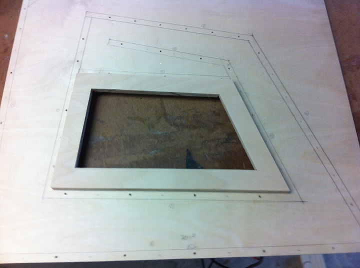

Here's the flange. The cool thing is that it will also serve as an alignment base for the internal panels. I made it a little wider, but I can cut it down some if there isn't room to get the speaker and/or my hands in there. I'm using the 3010LF - it's only got four bolts, so I'm hoping I'll be able to reach them all from one side and not have to put an access cover on the other side.

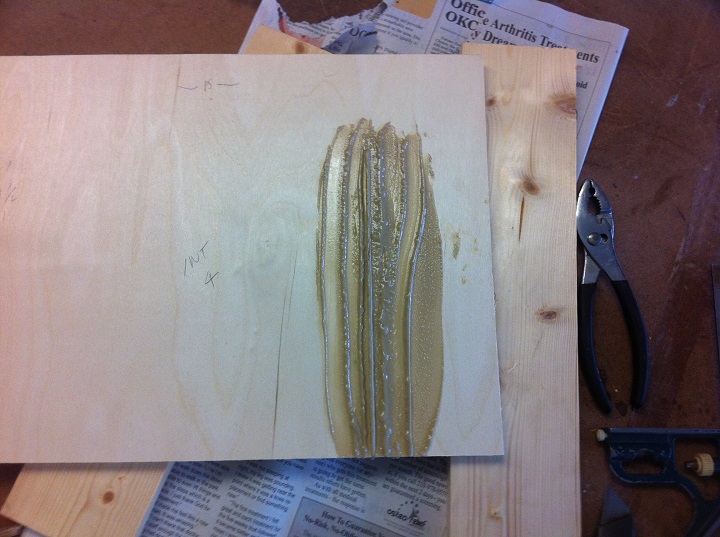

Bought two sheets of 5x5, but was able to save a whole sheet by using scraps I had left from other projects.....until the very last brace....just didn't have a piece big enough. But, I did have a piece with a saw kerf in it. So, PL to the rescue.....shoved it down in the slot. Drying now and will cut to size tomorrow....then it's time to put it all together. Speaker arrival is scheduled for tomorrow afternoon.

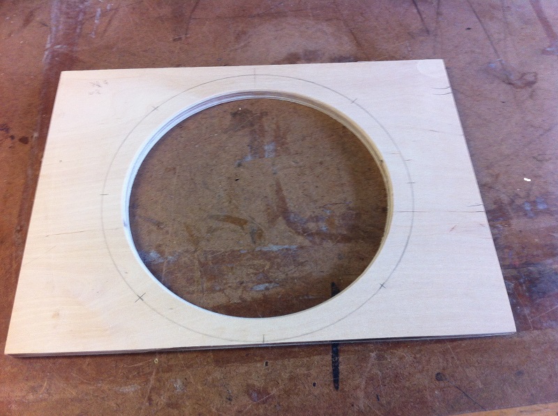

Got the driver today.....I'm gonna' have to do some shaving on my flange. I left it oversized because I like as much gasket tape as I can get on there, but the driver won't go through it. Tomorrow I'll whittle.

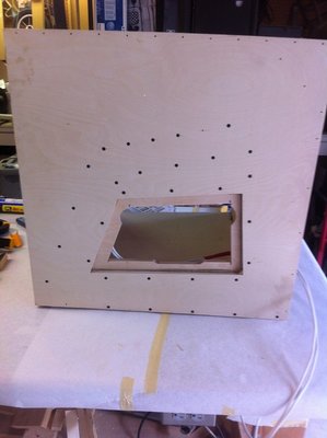

Here's an update.
Fixed the one-piece flange so the driver will go in....

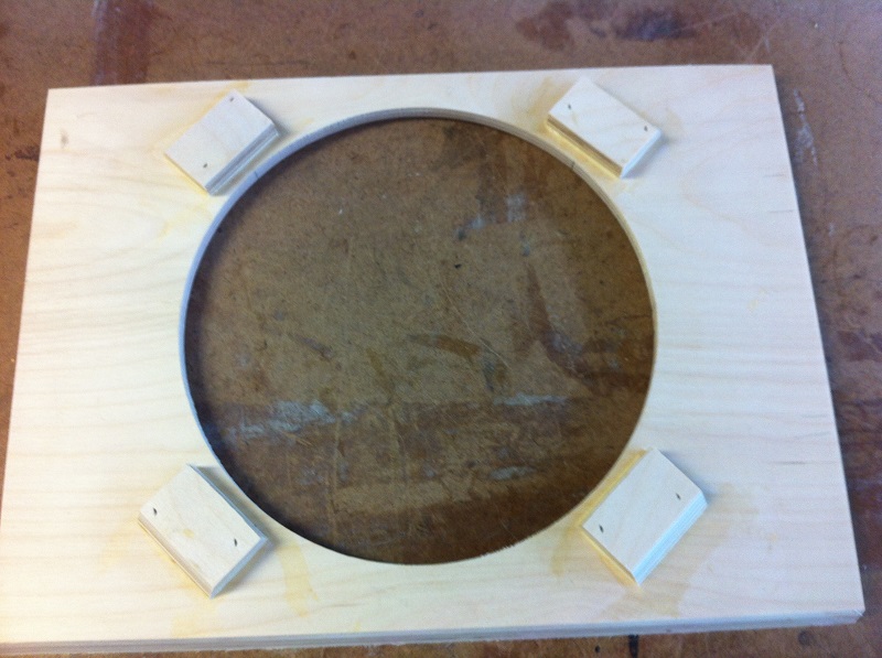

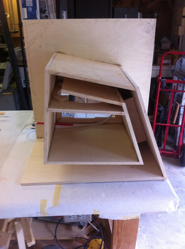

Cut out the hole in the baffle with the router and a homemade circle jig.....then rounded over the top edge a little with a roundover bit. Then added the backer blocks...

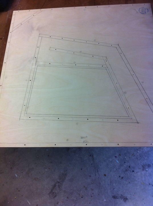

Then started putting on panels.......I pre-drilled the speaker cable hole. I think I'm going to install the speaker and crossover components before putting on the second side.....I'll use paper and masking tape to cover everything in the driver chamber, then pull it off after it dries.

I always try and install my speakons on the rear of cab, the opposite side to the mouth.
Building on what DJP said, if you were to still build a box for the crossover components, cut a rectangular hole in the back of the cab and mount the box on the inside with your connectors in the hole. You could still unscrew and pull the box through the hole for maintenance.

All of my speakons in all my cabs are in the back.Chris_Allen wrote:I always try and install my speakons on the rear of cab, the opposite side to the mouth.
I was looking at it this morning and I have room to get it all in the driver chamber, but I'm definitely going to put it all in before I put the second side on.
I'm never happy with sealing the speaker wires coming out of the chamber with PL.... it's drying now, but I may go back over the whole mess with hot melt glue and build a mountain.
