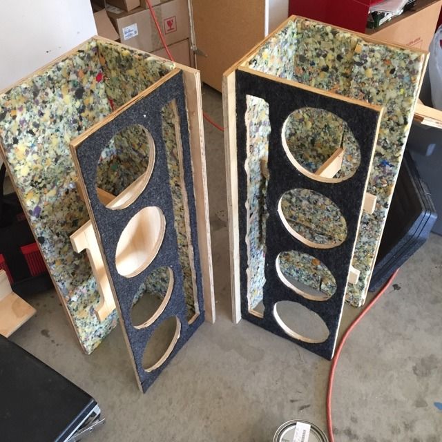

Im sure this is common sense...that I didn't have for the first baffle. for fitting the tweeter array, I found it easier to just cut the inner rectangle first, mark where the tweeter array screws are, then cut the half moons after with a jig saw. For the first baffle. I used a hole saw first to cut circles for the half moons, and then cut the rest of the tweeter hole. I still ended up have to trim with the jigsaw. im sure that's why Bill didn't mention that method in the plans. second time around I was able to fit the tweeters quickly
dampening the back and sides. I had some leftover unused speaker carpet from old cabs. so I just covered the front of the baffle in carpet to bypass gasket-ing the speakers.

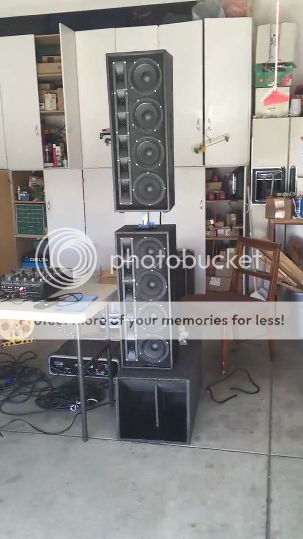

Speakers installed, duratex, and mounting poles. I just temporary used some random 1" pipe laying around. definitely gonna find a smaller pipe. Paired with my first BFM build, an Autotuba just to give the test some low end
Here are some vids taking with my Iphone, of course it doesn't do the actual sound justice but will post anyways.

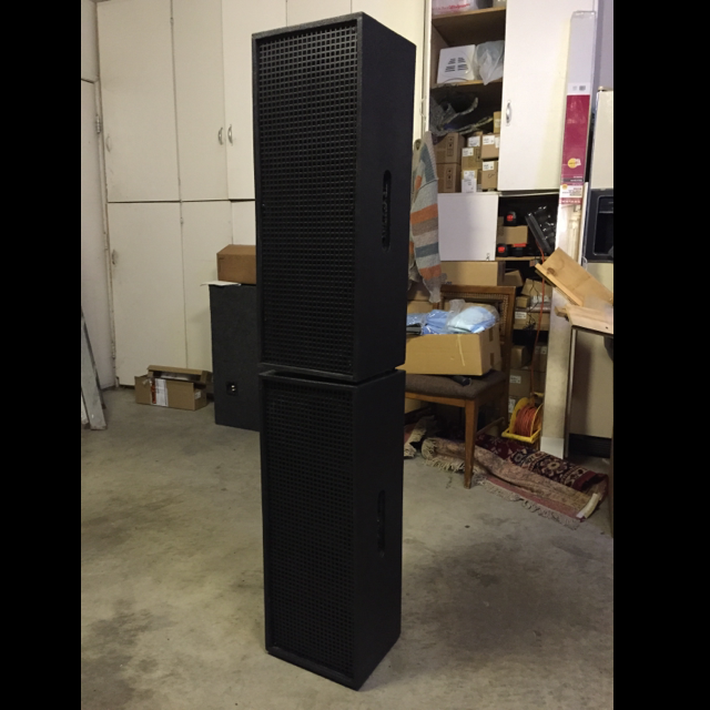

Just finished adding the grills to both. I was going to still add the weather stripping on the sides. But Im kinda diggin how they look.
I did use the foam. And they are barely touching the rim of the Dayton woofers. I hope it doesn't affect performance.

I generally don't like the square grilles but that looks top notch.

Chris_Allen wrote:I generally don't like the square grilles but that looks top notch.
Thank you sir! Yea I was pretty skeptical also when I purchased the square grills. I'm glad they turned out alright!

Oh man they sound amazing!! in my first post these a couple of links to videos of my first sound test. ofcourse they don't sound half as amazing on the video as it does live.
they do need some subs tho. I paired it with an autotuba I had laying around which sounded decent. but the SLA's totally overpowered the autotuba. Yesterday I just purchased some Kappalite 3010lf's on sale for 125 each because they were restocked. so im currently studying both the t24 plans or the titan39 plans and trying to come to a decision..but I cant :wall:

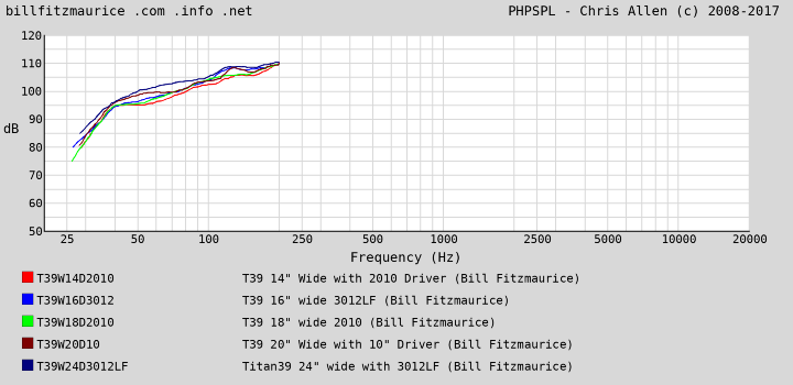

I'm really leaning towards the t39's as I wanna try the loud factor this time around. I built the tuba 30s before, 24-26 wide I believe. It wasn't until I unplugged them in a middle of a song that im like " wow there was so much bass I didn't even realize"
Do you have any advice on deciding the width "sweet spot" when it comes to convenience vs performance? I'd love to go 13" but feel like I won't be taking advantage of the 3010lfs.
Re: SLA pro Build
#11 Post by Chris_Allen »
I think a 20" wide cab is a sweet spot for a flat 50-70Hz range. On the narrow cabs, you will either have to boost low down and limit your output or have a crossover point around 70-80 with a 12db/octave curve to tame the rising response.
The difference in sensitivity between 20" and 16" at 60Hz is 3.5db.
