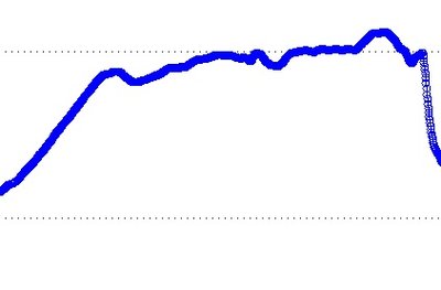

Sweet, I tried it this morning after setting up my iMM-6. Here is the graph I got from T30 cab 1 corner loaded. Looks like the right shape at least, but I'd like to get it so that it looks the same as the graphs in the thread "Introducing SPL Chart", is that possible without buying a calibrated SPL meter? if not, can you recommend me one to buy?
Thanks!
