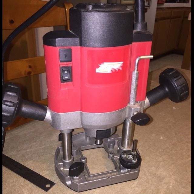

Hello all,
I've never used a router and really didn't know much about it. Luckily I was given this router today and I can't find a bit to fit on it. I tried both 1/4" - too small 1/2"-too big
Problem is there is no brand model number anywhere in the router to identify it.

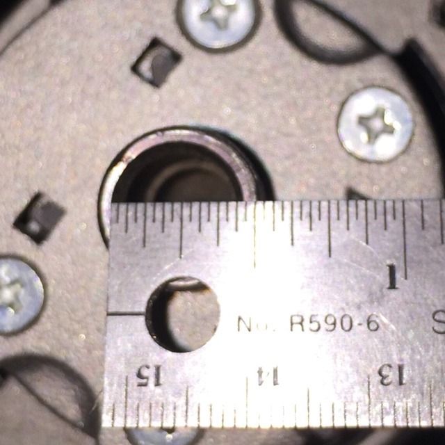

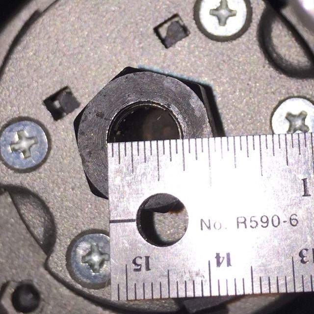

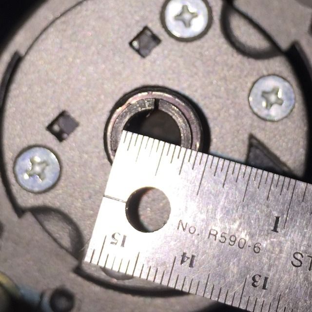

Took took some measurements of the holes, Collet and nut. They range between 5/16-3/8
Couldn't find anything with 3/8" in the store related to routers. Even took it with me to lowes and Home Depot, no luck.
I did find some stuff on eBay and Amazon but wanted to check in with you guys before I purchase online and possibly waste money on incorrect equipment
Any advise on getting this thing going? Or any body have any experience on routers that are not 1/4" or 1/2"?
Thanks in advance guys. Here are some pictures. Any help or advise will be great help.

There are 3/8 collet bits. You'll have to go to the specialty bit mfgs on the web. I'd see if you can replace the collet.

My guess would actually be 8 mm. It's a common router shank size here in the civilized world. :slap:
5/16" is 7.9375 mm

Metric!!! ahh makes sense. Thanks for the help Leland, Chris and Rune!
